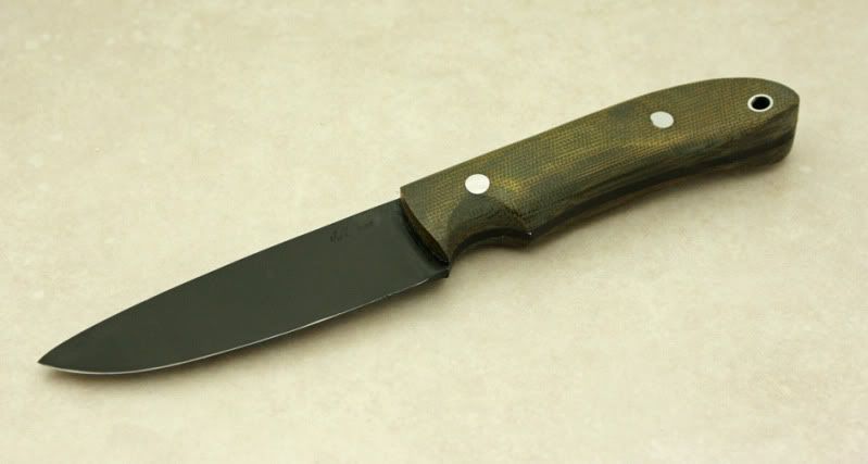

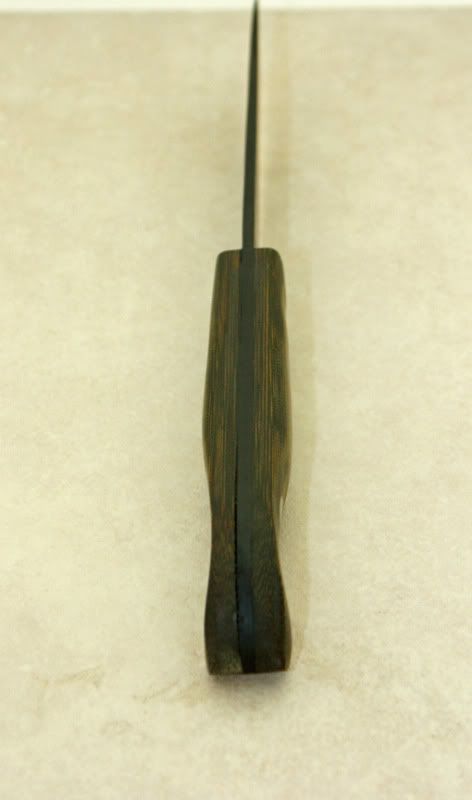

Here is the pic of the knife blade that I had Scott coat. It is ground from 1084. I just finished it last night so I have not had much time to test the durability of the finish but it looks great. The blade is evenly coated in a matte black. The pics are not great but you will get the idea.
You will notice on the spine that there is a gap where there should be epoxy. This is due to the fact that I had not had any experiance installing fully fitted scales. Usually the scales are attached and then ground down to the tang. Since grinding on the tang would remove the coating, the grips must be fit before coating. My biggest issue is that when the grips were clamped, epoxy cam squeezing out. Since any excess would usually be ground off later, it was difficult removing it before it dried but also not removing too much. I am sure with some practice better results could be obtained. I could also just fill the gap with epoxy now and have another chance to wipe it off cleanly while still filling the void.
John
Just FYI; Acetone will usually dissolve uncured epoxy. Cured Cerakote is not effected by acetone.
Also, epoxy sticks to epoxy very well, you can go patch that up. Cannot wait to see it after some abuse.

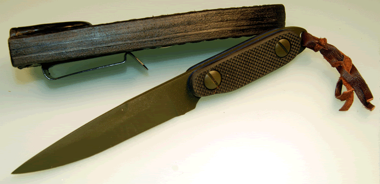

Here are some pics of the knife Shotgunner coated with Cerakote for me in Graphite Black. It is flat ground D2 with canvas Micarta scales and stainless handle bolts. I completely finished the knife before sending it off, therefore the whole knife (blade, handles, and bolts) got the Cerakote treatment. I did this mostly to see how the coating would look an steel and synthetics. It turned out very nice in my opinion. The main thing I learned is whatever you send to get coated be sure to finish it to about 400 grit. Even though it will be blasted with 120 grit medium this will not even out any high spots, so be sure the part has a nice even finish before sending it off. I will be doing a series of hard use blades in 5160 and canvas micarta and have the blades coated for corrosion resistance as well as looks. I will also report on the durability of this finish after some use. As it stands now I highly reccomend Shotgunner for anyone wanting/needing a blade coated. He is a pleasure to deal with and has a good turnaround time. Thanks Shotgunner.:thumbup::D

Dude! That came out awesome. The sheath really compliments the knife. The knife becomes a tool (perhaps an heirloom) in combination with the sheath. Great work Darrin.
Thanks for the kind words. I also had a pleasure working with you.

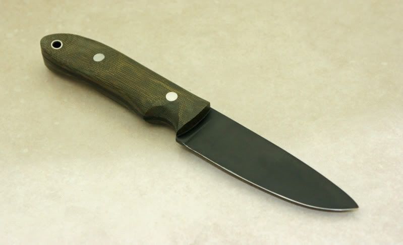

I finally got around to getting a picture up.
It is coyote tan. I wondered if there would be any flaking when I sharpened it, but I couldn't see any under magnification. I've chopped a bunch of wood with it, and it held up. There was slight discoloration where the wood was rubbed against it.
I also took a piece of wet leather and clamped it to a coated surface overnight. A quick drying and you couldn't tell that anything had been done.
