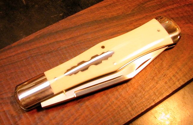

Wouldn't you like to make a great old slip joint knife you have seen but don't have the pattern? How about trying this out and let me know it works. If there is interest, we'll see if we can come up with more "challenges".
This is the same cokebottle pattern that T.Bose makes except Tony makes it even better with "Bose flair". You can see the old Challenge Cutl. Co. knife next to a recent T.Bose Ivory Cokebottle. The links below have more images of the Bose knife and the old knife for you to "chicken eye".
*** The Bose cokebottle blade and spring are made of 5/32" ATS-34. I'm going to guess that the liners are at least .040" 410SS and the bolsters are 5/32". I will post a correction if I guessed wrong.

OK I think Im up for the challenge. Is the drawing dead on or do I need to tweek it some?

It doesn't mater how dead on the pattern, tweeking is always required. It's pretty close, I always use the pattern as a starting point.
I printed out the pattern and its only 3.75" closed. I kind of like it this small if I was going to carry it. The original is 5 3/8" closed?

Yep. I put the 1" scale on there so folks can scale it up or down on a copier till the scale is 1".

I just mic'd it and the blade is .140". The radiuses are waaaayyyy bigger than 8" and closer to 14".

The inlay is going to be the biggest challenge for me. How do you guys do it?

The inlay is probably the hardest part of this unless you make it out of jigged bone or some other uneven surface.
On a smooth surface, Tony has a hardened template that is clamped over the handle material. Then at the mill, he uses a 1/32" end mill to cut the recess. Trace the outside first(up against the template) then freehand the middle parts. The mill will be dulled where it rides against the template but that's ok.
On a rough surface, lay the shield you are going to use on the bone and scribe the outline. Then, use a small chase or chisel to cut out the recess. I made my tiny chisel out of 1/8" O-1 rod and put a golf ball on it for a handle.

Look at the #1 post up there and find the drawing2 link at the bottom. That shows the pivot point. Way to watch ;)
