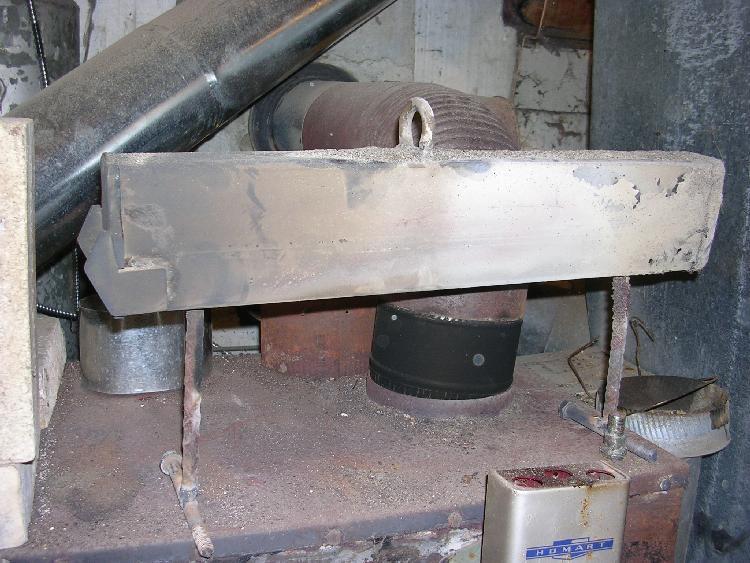

Is there anyone here intersted in making charcoal ? for your forge or Grill.
If you burn wood for winter time heat there's a good chance you'll be able to make charcoal at the same time, like I am ..
I'll post some picture if you're intersted in what I built to do this :)

Thanks for waiting on me guys.. Bruce I'm still kicking around ,, I wish they had softer boots though :confused: :D
guys add your gismo's too if you'd like.. I don't mind..

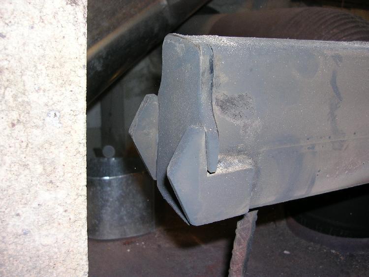

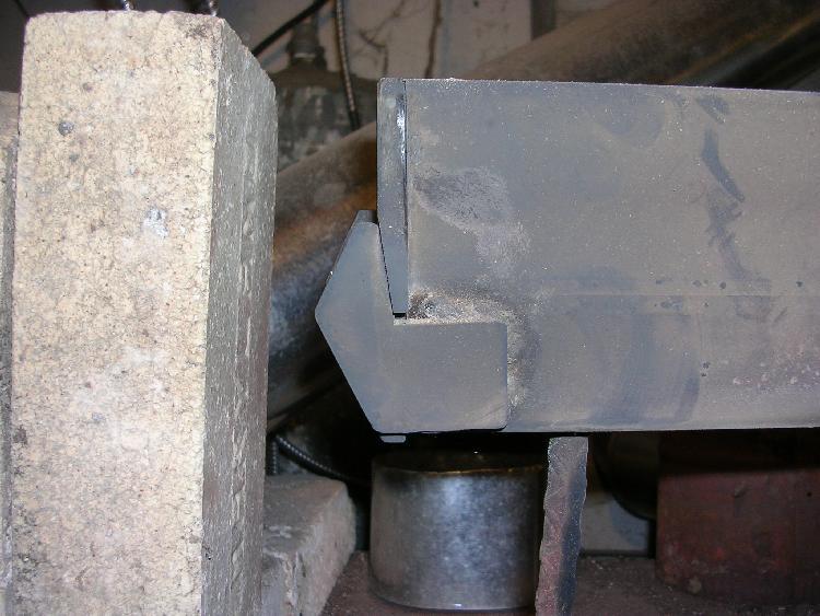

Here it is..
I built this to save the cost in wasted wood where as I heat the house with wood anyway through the winter
I just put it in the stove and let the stove do the work..
I used a piece of 2X4 streel tubing and two 1/4" plates
with 4, 1/8" holes in the bottom for the gasses to exscape.
The rest you can see how it's built.. the door is fitted to just slide and wedge in place..
it's working great so far..
OH BTW.. it holds, cut up 2x4 ends very well :)
