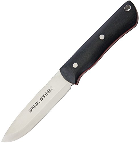

Thanks for the replies, guys and I totally subscribe to your remarks. In the collection I have a Real Steel in D2 (that I showed off on this forum) and I have no complaints about the blade so far. I also just got an EnZo Camper in D2, that I am planning to do a write-up about when I have time to take it outside. This latest Chinese mystery blade in the post just looks right and seems to have a decent leather sheath, in contrast to what aliexpress sells. I never bought anything there but sometimes browse the blades - the descriptions are just too amusing. If I end up ordering it, I promise to post some comments on it.

Real steal bushcraft knife, is d2 and is cheap for what you get. I was thinking about grabbing one for fun.

As I said, I have one of these and I am really happy with it. It's not a zero scandi, there is a micro bevel on it, but that's okay for me. The jimping could not be there for my taste, but it's not aggressive at all. It is a very comfortable knife and it comes with a decent plastic (kydex?) sheath. There are some extensive reviews on youtube, a couple in German, maybe because the knife is marketed by Boker. I don't have much experience with D2, so I followed advice gathere on bladeforums and touched it up with a fine ceramic rod once in a while. I am not sure it was even necessary, but I understand touching up D2 is easier than resharpening it. If you can get it at a reasonable price, go for it.
