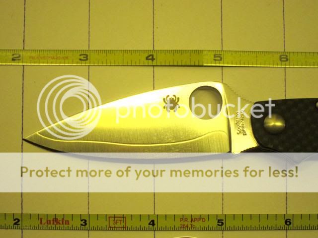

Choils can be good or bad designs...personal opinion...
Here is a good one.. it allows you to get close and personal, but you can see a "stop" that limits blade penetration BEFORE it gets to the choil.

...Essentially, you've built a stripped down sub-hilt...
Good description of the spyderco faux-choil :thumbup: It allows them to compact more handle into the design with an integral guard and slightly shorter cutting edge.
The spyderco Caly3 pictured above demonstrates this well, spyderco mislabels a groove in the ricasso as a "choil" when in fact a "choil" indicates the termination of the cutting-edge (where plunge meets apex). That "stop" mentioned by the poster is exactly where the "choil" is though there is no notch as usual to indicate it. The "subhilt" groove beneath it is actually NOT a "choil" per-say since it doesn't include the cutting edge.
Most knives designed like the spyderco from OTHER companies (e.g. kershaw) have an unsharpened bit of heel-edge above the unnotched choil, and I agree with others above who find that annoying. Kudos to spyderco (or Moki) for sharpening the entire edge.
But I am a fan of the larger true choils as well since they put your finger right up against the heel of the cutting-edge while still forming an integral guard and allowing even the least-skilled of us to sharpen the entire edge without leaving a blunt heel. My $0.02
