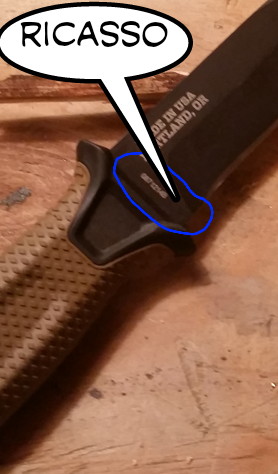

I knew we would get into definitions. Probably should have started the thread with such.
You're missing the point as usual....
If you use google images, you will find different terminology for everything...I just did that to check your "sketch"
Regardless of that wonderful diagram, it does not change the purpose of where you should and shouldn't put your index finger, and what the purpose of that area is.....
No buddy, you're missing the point...
A ricasso is not a sharpening notch as you imply.

I've always refered to and seen referred to the unsharpened portion of the blade between hilt and edge the ricasso
I believe that is correct. I just added a link to my last post with a diagram.
But one of the purposes of that unsharpened portion of the blade in front of the handle is a choking up hold on the knife that is still safe. It also serves as a stop for the sharpened edge.

I understand the ricasso to be the area of the knife ahead of the handle, and before the sharpened edge. Sometimes the "finger choil" or is put there, which I believe is what creates the confusion. And if I recall correctly, the choil is the name for the very "handle-most" portion of the heel of the blade, regardless of if it has a notch or not.

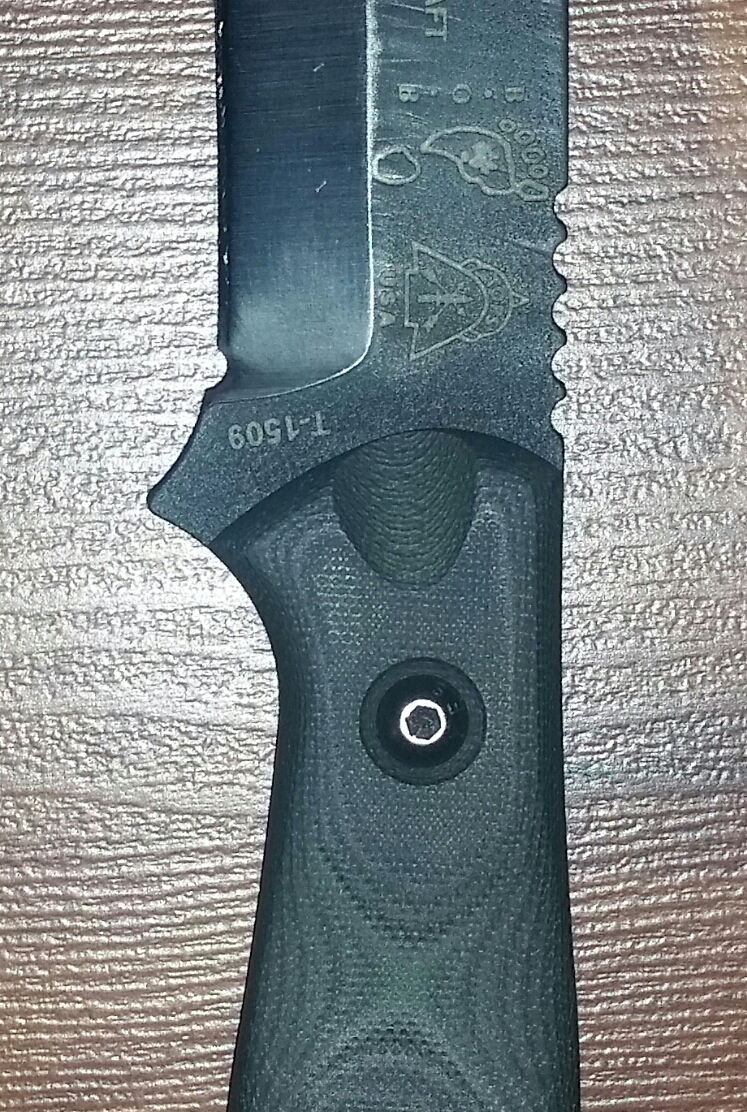

The BOB actually has a rounded area incorporated into the top side of the finger guard that actually contours to the shape of your finger quite well and works great to choke up on. My point was I'd rather have something like that on a knife rather than an sacrificing cutting edge with a traditional choil.

Again, if you want to believe that the ricasso, and the little notch behind it is a finger choil, so you should put your finger there, then be my guest.

There is no good reason to put your finger near the blade of a knife unless is has an area specifically "cut out" to do that, and one that is actually designed to fit a finger safely.
The point to it is control for more precise cutting with the tip/edge and it works great when executed properly.

To clarify, a choil can be part of the ricasso, wether it be a sharpening choil or a finger choil. The only person having a hard time with terminology is yourself.
There is no need for me to re-read the thread, I've already read it. While doing so, I noticed you were having a hard time with terminology, so I decided to help you out with a 1st-grade style diagram. That's when your feelings got hurt, and now we're here arguing and taking up valuable space in this wonderful thread;)
