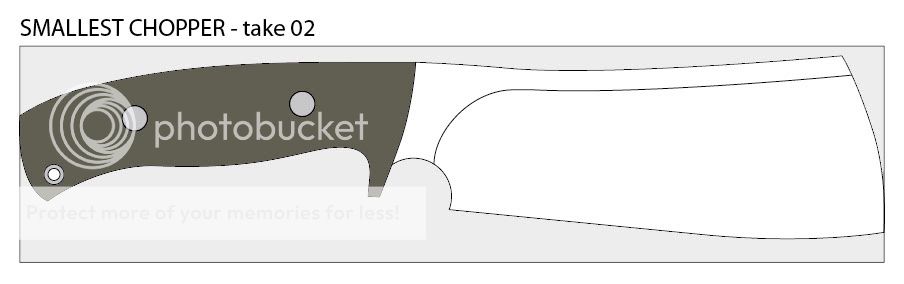

This is fun and I like it, but let me say it's hard to design a real chopper within those size limitations. :rolleyes: Don't expect too much chopping power, unless you sacrifice the handle which imho is not an option. Better yet, given those size limits I'd focus on the handle rather than blade length, as that makes the difference in choppers this size. That together with balance. But then again, I could just come out with more of a camp-like thing, with a wide blade of course, which can chop but ain't a pure chopper by any mean (because of limited length).

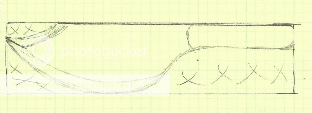

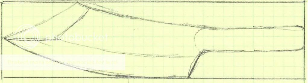

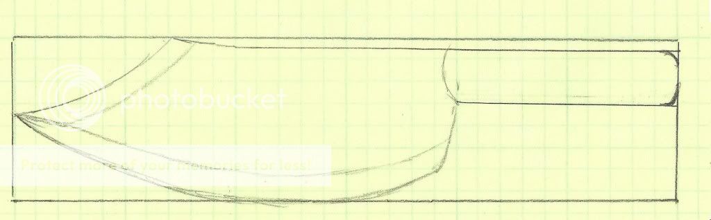

Ok, I'm going to post something now, it isn't going to be pretty but it should work -for the size- as a decent chopper. It's a game, right? Let's play. ;)
I'm still not 100% sure about the handle, but I have no time today to make a wooden prototype. I'm curious to see what others post! :)

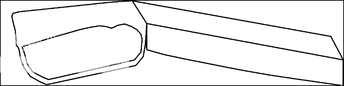

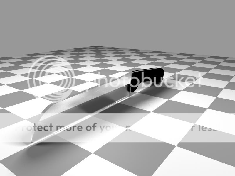

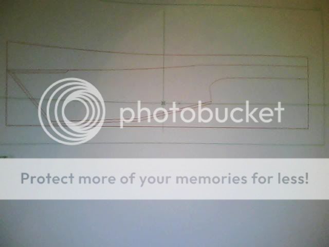

here's possibly my first entry, a 12.5" overall length chopper that fit's on a 12" by 3" piece of steel. Take that Pythagoras.
I mat refine this later if I can find the time. I'm not really happy with the blade shape. Maybe I'll try a drop point or tanto.
without further ado, here you go:
and a mockup in 3D:
closeup:
pending

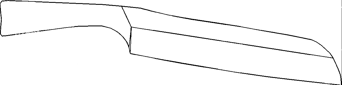

A few more ideas. The last one I'm pretty sure I saw from somewhere before, so if I have borrowed (stolen) the design, let me know.

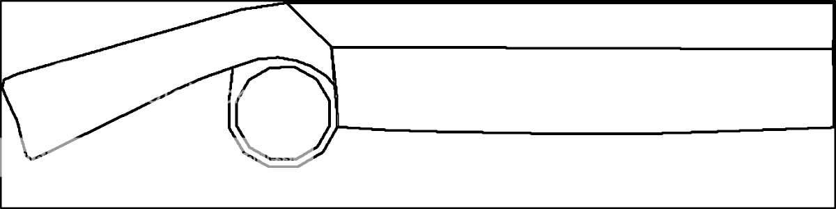

so my friend came in yesterday with a bloody finger after using his chopper. he overshot the log and his knuckles took the full force of the blow.
here's a couple of choppers with guards based off of his experience/ both are at 100dpi and at scale.
and
7-3/4 inches from tip to guard. Handle is 3-7/8 inches from butt to back of guard. 12 inches overall length and 1-5/8 inches at widest point of blade. Ring guard and lanyard at heel should give excellent control on the hardest swings. Blade hollow ground from spine to long, shallow flat grind edge bevel (30 degrees inclusive).

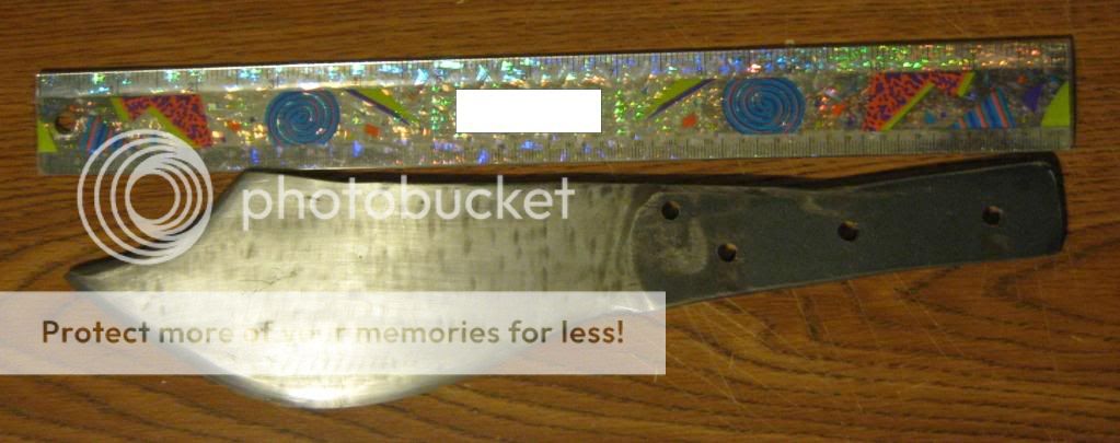

Also found this old POS in a box. Its I think my second knife. It was made out of stock exactly the same size as whats in this contest. Not sure about the alloy, but if someone thinks its a good design, I wouldn't mind seeing it done by someone who knows what he's doing. I had originally made it as a throwing knife, but it just occoured to me it would be a good chopper with a better grind on it.
