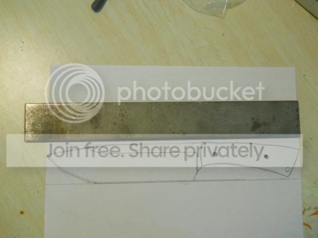

I made up this design for a 7" blade chopper today, im pretty happy with it but wanted some opinions/advice/critsism from the WS&S crew.
this was designed to be a simple and hard working chopper.
this will be made in .187" 1080 with canvas micarta for handles
so here are some sketches, let me know what you think!
ETA the blade will be about 1" bigger I scaled it down for the paper
For chopping, I'm all for putting as much weight as possible toward the tip of the blade. So, unless you're married to the looks of a clip point, maybe you could make it heftier at the tip instead of lighter.
I'd sweep the tip up to the height of the rule and then have the spine gradually rise from the handle to meet it...if that makes sense !
I totally agree. The tip is the first thing I noticed and if it were my knife, I would prefer a stronger tip. However, what you designed looks really sharp. I also like the wide blade that will make early contact when chopping, keeping the knuckles out of the way. Nice!! The slight curve to the handle looks good too. I'd keep the design the same, just strengthen the tip. Yes, it may change the looks, but who wouldn't want a chopper made to be a beast?

Length/weight/proportion has everything to do with thickness and tapering as well. you can make a short blade chop with a tapered tang and a long blade balanced and lively with a distal taper. Where you put the mass IS important... but it can be accomplished in more ways than handle/blade ratios.
also.....
I would prune the plunge line by extending the integral fingerguard to break into the blade. There is still plenty of material for the guard and you've removed the stress points where the edge ends. It also makes for easier sharpening.
Like this...
here is an updated version taking into account ricks advice and adding a stonger tip.
im keeping the blade at 7 in, its mainly a chopper but I want it to have the capability to make firesticks as well as other things.

Drew - I really like your redraw!
I thought Rick's take looked nice, but that spear point looks good!

If it's not too late, I would round off the top side of the handle butt. I'll sometimes get a grip at the end of the handle when chopping, and that pointy butt will make a hot spot in the palm.
I will its very rough right now.
Will you be tapering the tang or skeletonizing it? Just thinking of how you could push the balance point further forward.
