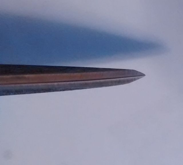

The first couple of inches are acceptable, but as I said, the edge shifts to one side around the belly. Pretty hard to capture, but here is the tip so you can see the uneven grind.
I'd convex that secondary bevel with a slack belt. That would even out the edge and I'll bet you have a whole different animal on your hands. Won't take much IF you have any access to a belt sander.
I do. Did a few knives myself, but messed the tip of one of them. I don't want to mess this one up.
I hear you man. The tip's the easiest to burn or remove too much stock. And I don't know that I can explain well enough where you'd feel comfortable tackling it. If you decide to send it off, I'd look for someone reputable close to you. That would probably be the least expensive and quickest fix. I get that the honeymoon's over, but I think you've got a good blade in your hands that just needs some attention to that edge.

It does when you don't remove enough material from your primary edge. As I said, the first 1/3 or 1/2 of the edge is half decent, but from there to the tip it's just sad.

That steel is not hard to reprofile. I'd just strop it on progressively finer grits of sandpaper until it looks right to you and call it a day.
