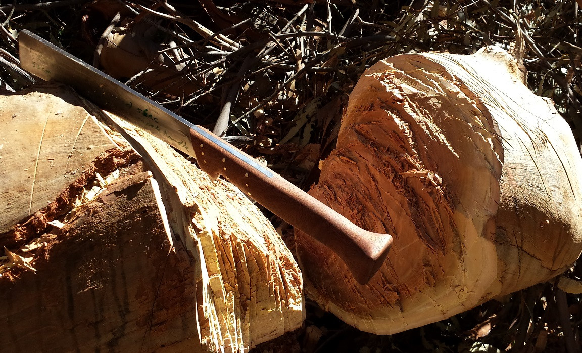

Time to test my experimental chopper: 52100 1/4" thick, 21" OAL, 12" blade, 2.5" wide, super quenched, 56rc, 13dps, 0.025" behind edge, 2 handed figured Sapele handle. Partial tang because my oven is not long enough.
I planned to chop through a 13" dia Eucalytus tree trunk. But end up chopped through a 18.5" dia trunk. 2 hrs and 15 minutes of sweat, along with 3 blisters on each hand. Edge still slice newsprint afterward. Instead of my daily open water swim, I double the amount of work-out with this chopping exercise.
My camera ran out of battery after 90minutes. Sensible thing, I won't upload long & boring videos to youtube.
Yep, the head was on the heavy side. After my long outing, I reprofiled the blade to pull the balance back to around 2" in front of the handle and conducive to higher velocity swing. Now its weight 1#13oz.

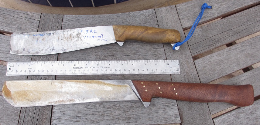

Pic along with my 52100 58.5rc bladesports spec chopper w/ White Teak Burl.
It does look like the head is heavier/wider.
More pics please. Interesting choppa.

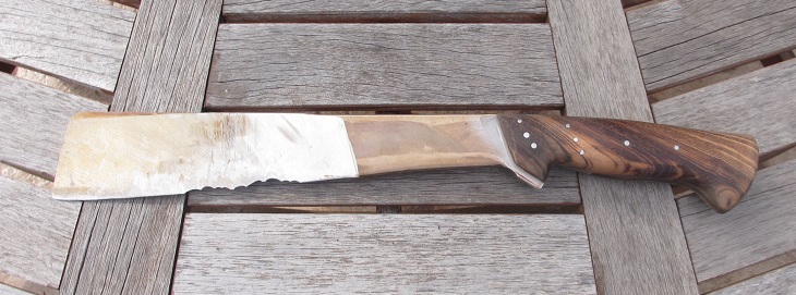

I learned from this chopper, after chopped boulder & nail fine but knotty pine:confused: ... took a little time to investigate to realized simple physics.
SQ 52100 18.5" oal, 62+rc, 12dps, 0.02 behind thickness... blade got re-grinded multiple times. Same result with seasoned knotty pine. Chop at the end of the log at around 45 degrees entry, where wood blow-out but edge caught & or steered inward by knot.

Such a pretty handle... :( Might have survived at 0.030 but, like you said, loss of cutting efficiency... or did you try that and get the same result?
I didn't tried 0.03" thickness. Initially, I thought all chipping were due to ruined tempered (turned brittle) from grinding. Grinded away all chips - lost around 4mm blade width/height. Chopped huge rocks, made 2 track around 5mm deep and few cm long - no problem. Back to knotty pine, chips after chips - yeah I was not happy. Later on, while digging out embedded chips, my aha & duh moment to realized the simple physics involved.
From probably 1K of chops and tracked various interaction params & results. I conclude 0.023 - 0.026 thickness; 12-15dps refined edge; 55-59rc are in optimal range for choppers.
