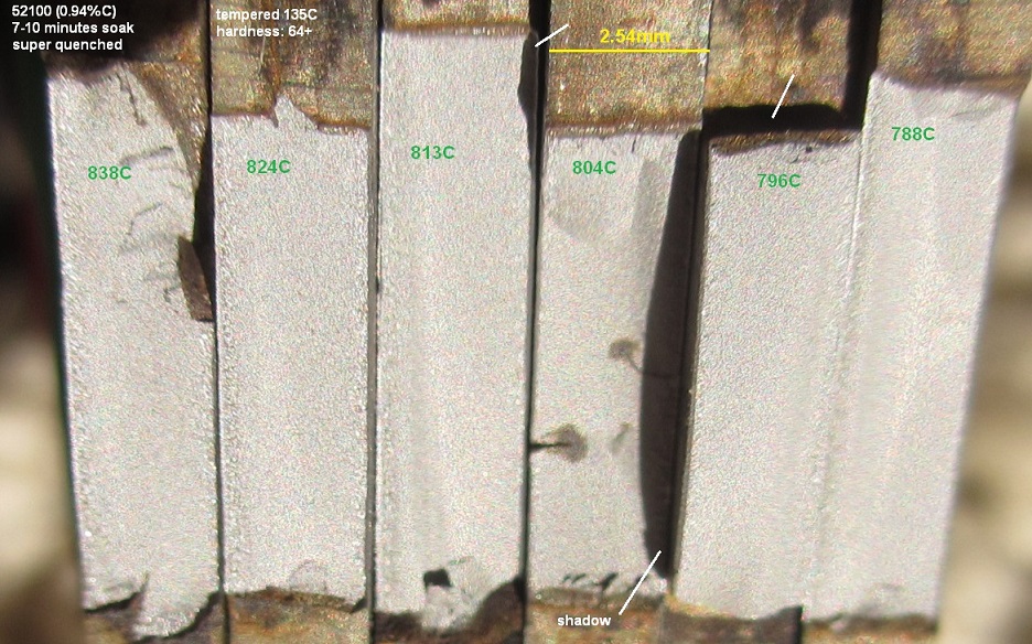

Here is a macro view of my 6 paring (coupon tip - where I broke the coupon off to see inside).

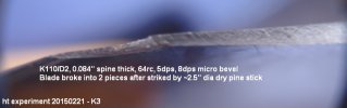

Here is a video abusing a Benchmade 15015 Skinner in D2 steel at 60-62 Rc - stock thickness is 0.14" and the edge is probably >0.020"... yeah, it's a fat little knife, but it shows that D2 isn't necessarily "fragile" as some might contend, though still not a rational choice for a chopper even if you CAN get it to work.
[video=youtube;yMIF_Xk-Bos]https://www.youtube.com/watch?v=yMIF_Xk-Bos[/video]

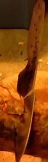

It took about a day to ht and prepared 4 knives for this test. I set out to break at least 1 knife. I am happy with the result, looking forward to make a 1/4" thick D2 chopper with ~62rc + 0.025" edge thick + 13dps.
Dry pine & white oak sticks strike down on a blade edge, where the blade spine is rested against cutting board. Hence termed reverse-chop.
All knives are 0.084" spine thick
Knife1: D2, 62rc, 9/10 dps (9* bevel, 10* micro bevel), 0.019" thick behind edge
Knife2: D2, 62rc, 8/10 dps, 0.015" edge thick
Knife3: D2, 63rc, 5/9 dps, 0.01" edge thick
Knife4: K110/D2, 64rc, 5/8 dps, 0.01" edge thick
Thanks for watching & comments.
[video=youtube_share;sz6OlNKRSWs]http://youtu.be/sz6OlNKRSWs[/video]
Microchipped
Cross section of a broken piece
edit: Finding out at what angle and thickness, my D2 blade able to whittle & feather pine wood.
I reprofiled the remain of the broken knife to almost zero grind. Sharpened to 3dps with behind edge thickness around 0.002". Slowly increase the bevel angle. Finally around 6-7dps & 0.004" thick, it whittled & feathered test (at least 50 cuts w/o edge deformation).

After examined and thought about the test blade breakage. See how the wood twisted grain steered the front of the blade more to the left than the other half. I don't think a thin blade in any steel with hardness > 61rc would survive this much sheering - quite a large gap at spine. For lower rc extra tough blade, its edge would mangle badly as well. What I get out of this scenario is don't pound a thin blade into twisted wood. In order to pound a blade into such wood, I would need a thicker blade. Where extra thickness: 1) wedge - limit penetration 2) arrest sheering 3) resist steering.

Today, I cut 4 paring + a 24cm gyuto 52100 blanks. OK, the gyuto is for keep unless ht mishap.
I will go for ultra low hardening temperature - gyuto: 1440F; paring: 1435F, 1430F, 1425F, 1420F. FYI - 1450F considers bottom low austenite temperature for 52100.
Why? I seek super fine grain & 99+% lath martensite (tougher microstructure than plate martensite for steels with more than 0.9%C).
Target hardness gyuto: 64-65rc, paring: 62-64rc.
Your thoughts?
