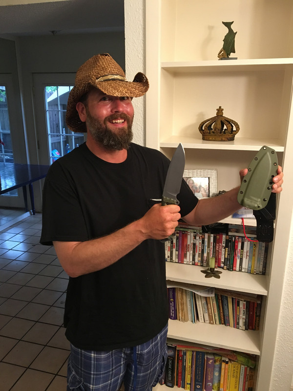

Needs moar pictures.
My brother with his (thanks to @6850 !):

I'm curious as too who made old Choppy? Also your brother reminds me of Toby Keith for some reason.
