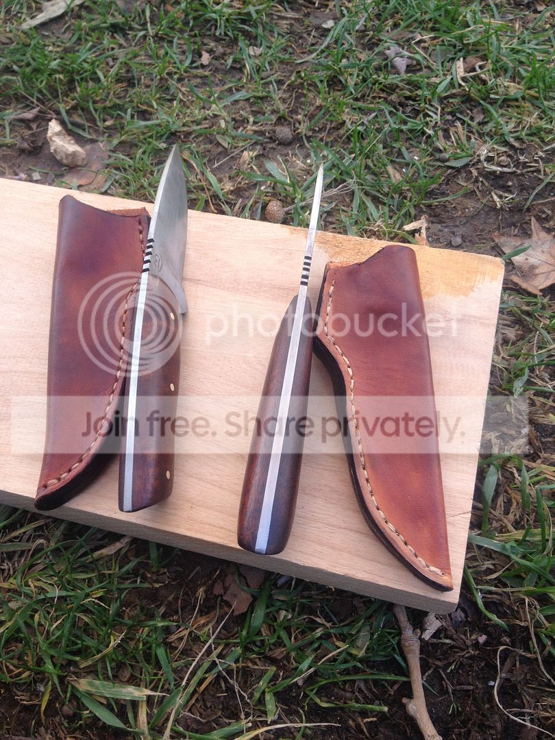

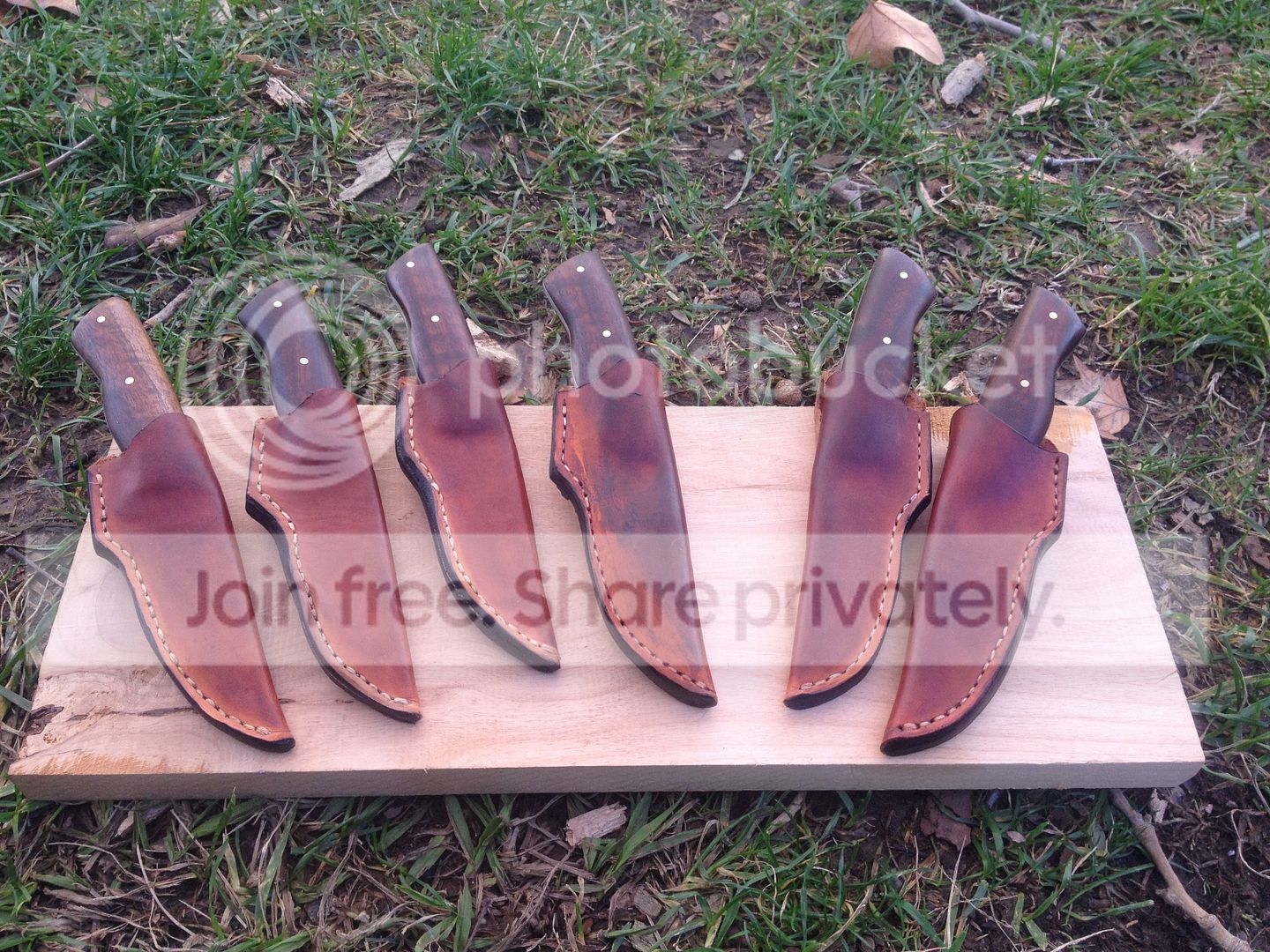

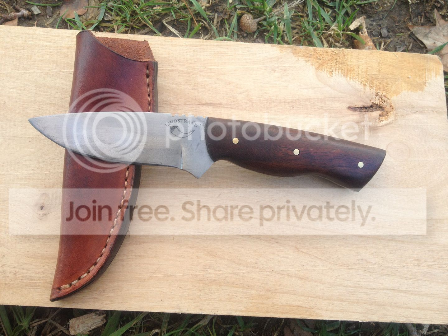

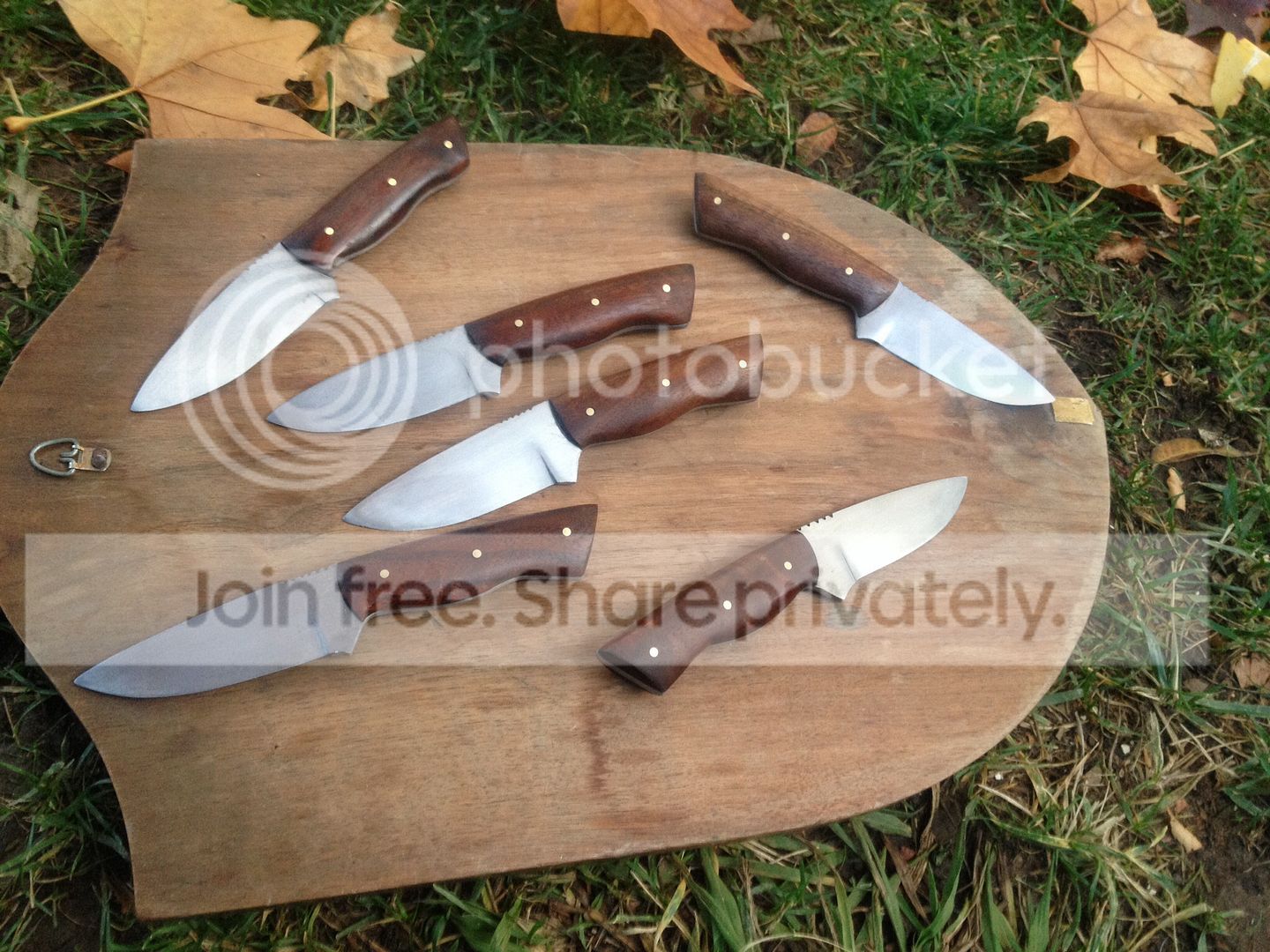

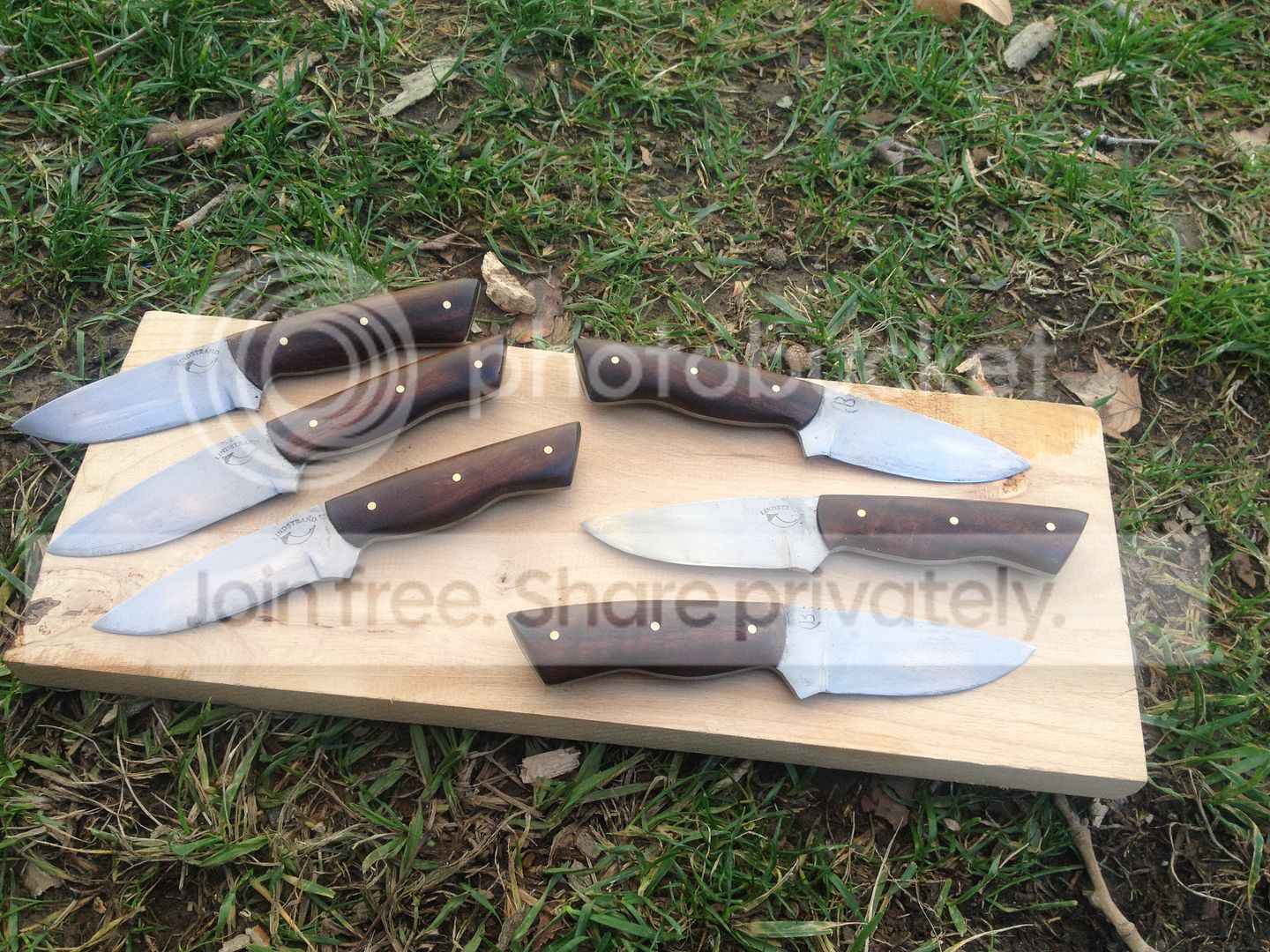

Hey all! Here are some knives I made for Christmas gifts. All are 1084, scales are figured walnut from a repurposed rifle stock blank. This was one of my first tries jimping, and I regret not using a hacksaw…I used a triangular file and the hacksaw idea was later brought to my attention…duh. I tried really really hard to get nice crisp plunge lines; I think they are a definite improvement from my last knives, but I know I still have improvements to make! They fit very well in hand and cut very well. Im pretty happy with them over all. My leatherwork is well, coming along; Im learning a lot and enjoying doing it! I still need to get some basic tools that will enhance the look of the sheaths a lot though (edge beveller, stitch groover, etc). Anyway, please give me any feedback you have!
Thank you for looking and Merry Christmas!
Nice looking handle materials. The finish on your handles is looking better too. The finish on your blades looks uneven though. Is it patina? Or epoxy?
Ah OK that makes sense. You already pointed out the plunge lines, which I think should be your main focus on your next knife.
Also, be careful using a triangle file for your jimping. They can be significant stress risers. One of my dad's cheapo knives broke right at the jimping.

I'm really trying with the plunge lines...I'm having a heck of a time making it so they don't get washed out while grinding my bevels. I'm going to use a hack saw from here on out...but never thought they would be such a weak spot!

I really like your sheaths.
I think you're going to make some people very happy worth those knives!
A trick to getting a good plunge line is to start about 1/4" ahead of the planned plunge line.
Grind your bevels, then overlap your belt on one side about 1/8-1/4" and then gently start at the planned plunge and gently blend in to the first plunge line. Gently is the key.
you will get a nice radiused plunge. If you use a file guide it will even go better.

If your using a triangle file for the jimping you can take a tiny dowel rod and wrap some 60 grit around it and wash out the point at the bottom. The key is to not have any sharp angles at the bottom as Shane mentioned.
