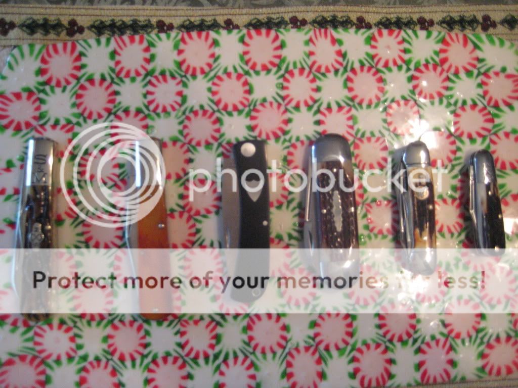

So, I decided to ask Santa for some traditional folders for Christmas this year.
I went for a cross section of styles, and makers.
Two GEC Northfields, Two Queen Collabs (one Burke, one Pardue), a Schatt and Morgan File and Wire large Barlow, and an Large AG Russel "Sodbuster" style.
from left to right.
S&M Large Barlow, Burke/Queen large Barlow, AG Russel Large "sodbuster", Northfield Sunfish (steel bolsters/liners), Queen/Burke Canoe (also appears to have steel liners/bolsters?), Northfield mini barlow. (also got two sheaths, and a CS spike hawk.....as well as some non knife related swag).

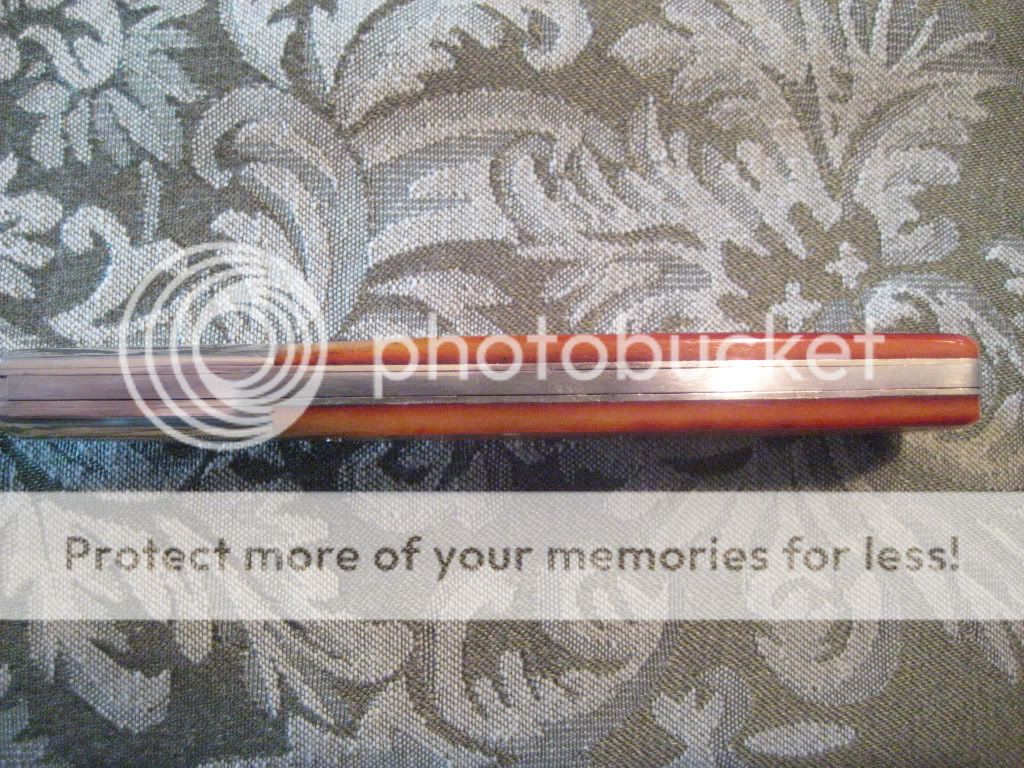

Next up is the Burke/Queen large Barlow. The finish on the back spring/liners is not top notch on this one. Some gaps pm either side of the back spring. But the spring is strong, and the feeling is very stout. No side to side wiggle. I really really like the feel, and look of this knife. Aside from the gaps on the back, the only thing I would change about this one is the bolsters. They seem like a perfect place for a nice stamp. the Queen Q, or Burke would have been cool. I just like stamped Barlow bolsters......... It would also be nice with a long pull, and to be more pinch-able.
This one will be a keeper, and user. I can't say enough about the color and texture of the bone on this one. It is just great. It feels neat in the hand too.

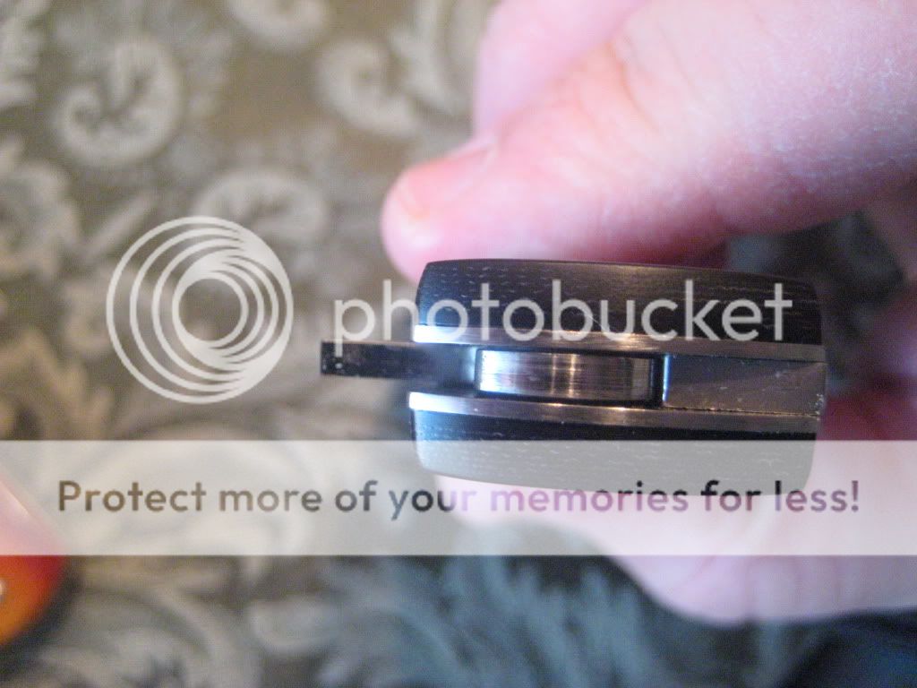

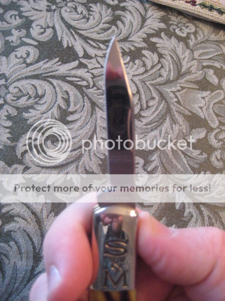

Next up was the Schatt & Mortgan File and Wire large barlow. This one is a real looker. Absolutely stunning. To hold, and feel. The bone is smooth and glossy. Probably my favorite bone I have held! So nice looking.

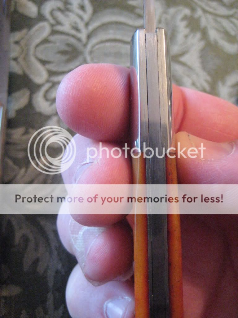

Too bad the spring to liner fit is terrible. The You can see daylight between both the liner to spring fit, and between one bolster and liner! It is weird because the fit of the bone scales to the bolsters and the liners is perfect. the polish of the springs looks like they took a lot of time to get it right.
As with the Large Burke/Barlow, the gaps would not be a deal breaker. The knife is just that pretty. However, the blades don't feel near as solid. There is a bit of movement side to side on the main spear. There is even more wiggle on the lovely small clip point. Almost a rattling wiggle. This will definitely bother me! The pulls on both blades are very light.
I am a bit sick about the issues on this knife, as it is the coolest most lovely feeling slip joint I have ever held!
You can see tablecloth through both the spring-liner fit and the bolster to liner fit. Again, this would not be too much if the blades were tight and solid. I will have to figure out what I am going to to get this one fixed.

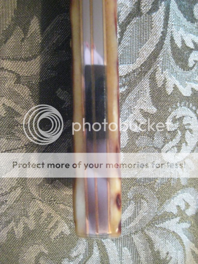

Last up is the Pardue/Queen collaboration.
This one also appears to be steel on the liners (as did the Burke). The bolsters may also be steel, or nickle silver. But the liners are definitely not brass on either.
The Steel is D2 again.
Fit of stag to bolsters is great. The liner/spring/bolster fit is not as tight as the GEC, but there is no light coming through these. They are just a little less polished looking than the components of the GEC before assembly.
This is a very solid knife side to side. All three blades are tight from side to side. The springs are soft on this one. Very easy to open on the blades. You can open them with even pointer finger nails easily.
Note, no see through gaps. Just seem to be a bit "rough" on the liners before assembly. (but nice and solid for sure).
