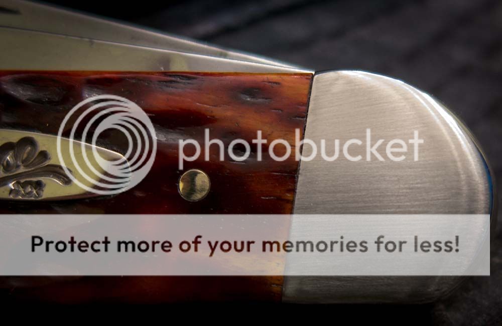

So far so good, while it doesn't have super steel, it needs a touch up now and then, it does get very sharp! I took some very fine sand paper to the bolsters last night as the nickel polished bolsters are fingerprint magnets and also show any small scratch right away. This brushed finish is easy to apply and easy to maintain. Just take a small pad of the sand paper and thumb it straight away from the scales to the end of the bolster, keeping in a nice straight pattern.
Sowbelly_bolsters_brushed.jpg~original
bolster_brush_finish.jpg~original

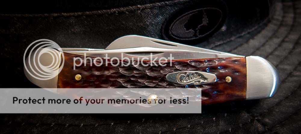

But, I couldn't continue with the sheepsfoot being up so proud of the rest of the pack, so, I ground down the kick as I've read some others have done, also flattened the swedge slightly so it isn't as crisp when gripping the knife with the main blade out. I took it real slow, checking often for how much further I could drop it down and this suits me fine, here is a before shot of height of the sheepsfoot and a few after the operation;
sowbelly_sheepsfoot_drop.jpg~original
sowbelly_sheepsfoot_drop_closeup.jpg~original
I didn't have presence of mind to take a before shot of the kick, but picture it coming out to form a triangle and I clipped off the tip;
sowbelly_sheepsfoot.jpg~original
It's much handier in the hand now and also the pocket as well :)

The folks couldn't figure out how nice I ground down the middle blade to fit as well as it did, then I explained that I didn't grind the spine of the blade down, just the kick so it would lower the blade further into the handle, they all went Ahhhhh :)
Much nicer this way, glad I didn't wait to long to do so. I used the Worksharp Ken Onion model to grind it down, very handy tool that !
