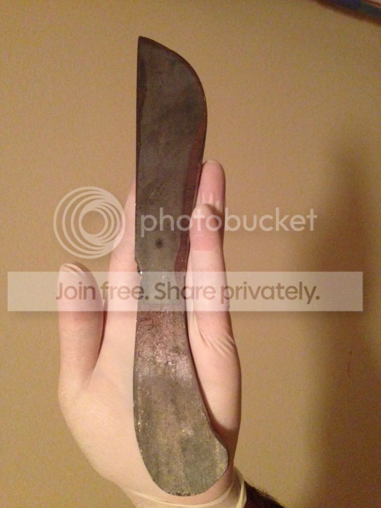

Finally musterd up the courage to order a bar of steel and try my hand at creating a blade . After reading the shop talk threads and watching as many YouTube videos as I could regarding the subject matter , I decided I had enough information to start the process . I am a physician angle grinders , belt sanders and files are new to me so please bare with me if I sound like an idiot . I humbly ask for any advice you gentlemen can give me .
PROGRESS :

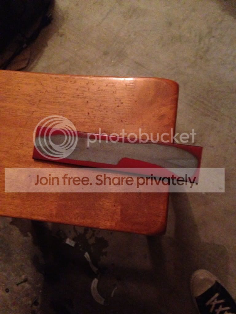

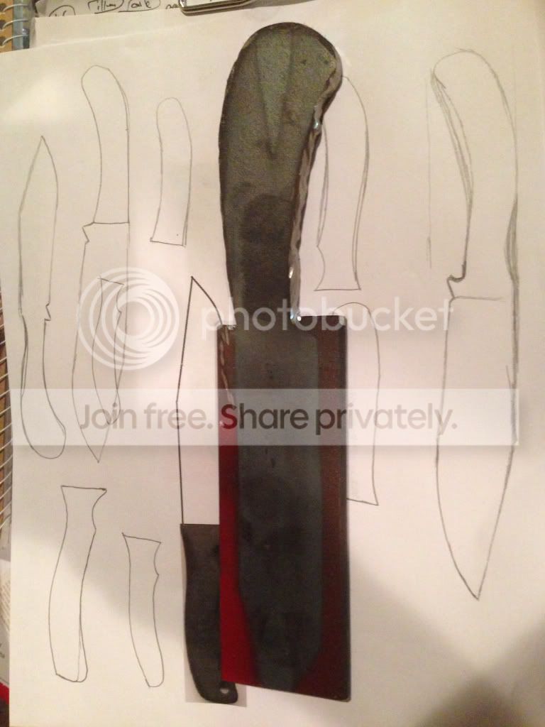

The journey began with a 18"x2"x.26" bar of 5160 steel . I settled on a design and cut it out of cardboard . I then placed the cut out on the steel and spray painted over it . Here came my first mistake , I decided to change the design as I was cutting the steel and ended up over complicating things . Since I had zero experience with the angle grinder I asked my friend to help me cut out the ruff shape . Amateur hands with the Angle grinder caused a few dings and uneven surfaces on the blade . I used a bastard file to clean out the dings and smooth out the surfaces as much as I could and managed to clean most of them out . Then it was time to close up shop and call it a night . MORE TO COME .

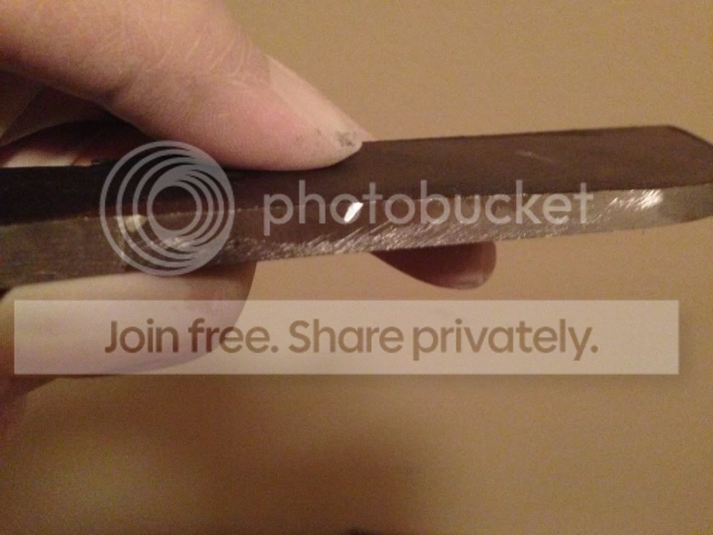

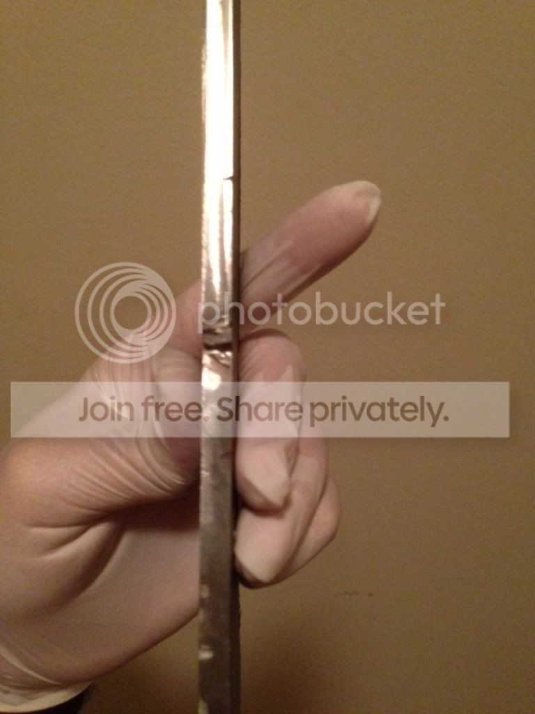

Above picture is of the spine
Above picture is of the edge

1. 0.26" was too thick to start with , Specially with hand tools

What is your opinion on the design and what would you change if you could ?

You're right that .26" is way too thick for a knife of that size. I'm not saying that it won't work, but that it won't perform as well as it could. Basically, the cross section of the blade is a triangle with one leg being .26" long. The other two legs will come together at an angle that's rather steep. This intersection is the cutting edge of the knife, and if the angle is too much, you get a splitting wedge more than a knife. That's why you see knives of this general size being made from stock that's .125" or so.
Overall design is good and functional. I like the blade shape for a general-purpose field knife, though I can see some might like a more pointed design. The only thing I would change would be to shrink the bulbous pommel a bit. It looks a tad unwieldy, but it you made it into more of a hook shape, it would give the pinky some room and still prevent slipping a good deal.
As thick as that steel is, it will take a lot of lightening holes in the handle to bring the balance and weight to a good zone. You could remove 90% of the metal in the tang and not sacrifice real-world strength.
My suggestion, scrap the blank. You can always use that metal for guards and pommels, but trying to bring it down in weight and blade geometry is going to be a lot of work. By the time you get that squared away, you will have removed half of the metal - so you can just as easily order another piece that's a better thickness and get a good working knife out of it in a few hours work.
And don't feel bad, I had the same thing happen to me when I made my first few blades out of leaf springs. By the time I worked through the rust, pitting and hairline cracks, I had burned a lot of sanding belts and hours of sweat to end up with a piece that was about .130" thick. Hours of work on that "free" metal to end up with a blank that I could have purchased for pennies! Ugh!

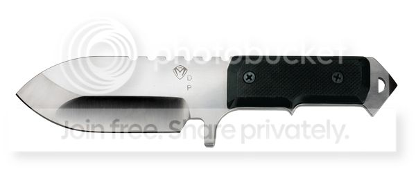

Greg Medford makes a few blades in .26" thickness ballpark but I'm not sure about the performance . I think one of them is called the Sea Wolf . What do you guys think ?

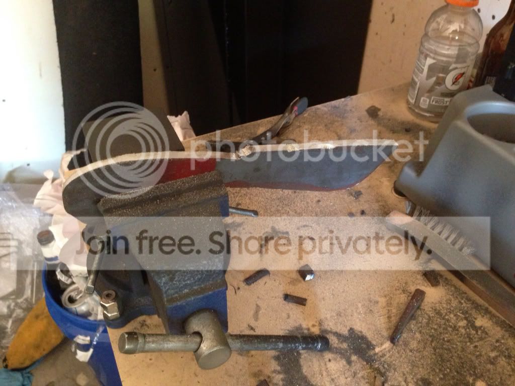

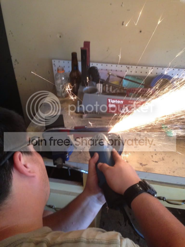

That grinder is a rabid animal waiting to bight off your finger or put metal in your eye. Knife making = fun......hand grinder used like that = hospital. Good luck and be careful.
And in your lungs. Get a respirator and protect yourself. Good luck.
He has s complex multi grind on there and the result is that that hollow is very agressively deep and gives you a thinner edge.

Appreciate the safety tips guys . That is actually my friend the Marine in the picture with the grinder . I asked him to wear a mask but he said he had worse things fly at his face to which I replied " That's what she said " . I'll make him wear one next time .

Sunglasses don't cut it with an angle grinder either, those sparks sneak in under or from the side.
It's true, they use a dremel and burr to grind the rust spots off your eyeball.
I too would set that big chunk of metal aside. At some point you will come back to it with the right idea for the material. Draw filing is how to achieve a nice flat plane, any good file will work but a Long Axis Lathe File will draw file better and the Magicut file is supposed to be a step above a standard file. There are whole threads dedicated to files, worth the read. I have the bevels filed into my first knife, posted pics on here under the thread "What I am making". I still had some sanding and a little bit of file work left at the point of the pictures, bevels were not exactly even, fixed now. I did it all with a Nicholson 12" bastard file, hacksaw with Nicholson blades, and sand paper. The videos by Sugarcreek Forge helped a lot and I recommend checking them out. Good luck.
Do a distal taper, and the last 1/2 of the blade might get a useable edge. Go full flat grind as well. you could also surface grind the whole knife thinner. Go down to at least 3/16, and preferably 1/8". I say finish it. It will be a reminder of what you learned along the way. I look at my first knife and smile to myself. I am very new at this but the progress over 9-10 months has been staggering. I kept a couple blades I shattered in quench as well, just as a reminder.

It's not that it won't hold an edge, it's just so thick, like a splitting maul
This is a good summation
Y
... I'm not saying that it won't work, but that it won't perform as well as it could.
