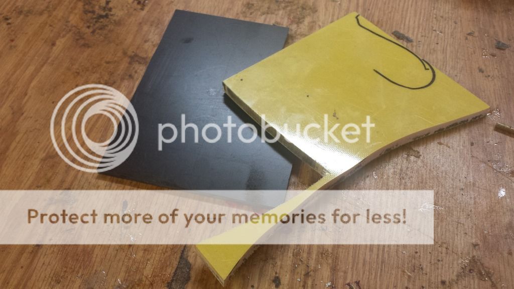

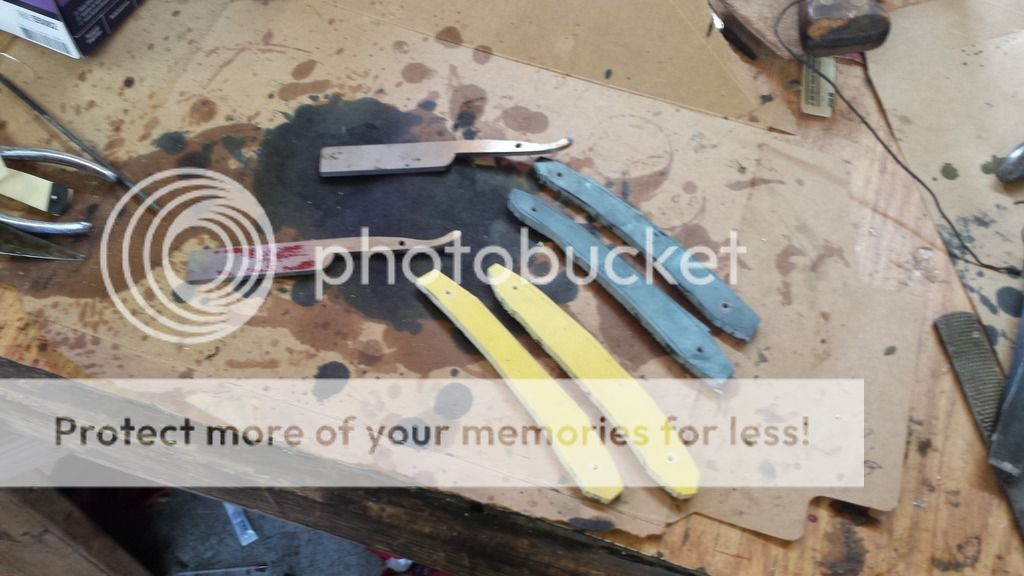

I started of with just scrap I had laying around the shop. Some 01 tool steel which will be perfect for a razor, and some pieces of g10 taking up space. I know that Murph likes the yellow, and I like black..... Perfect. I will make two of them, and gift one to Murph.

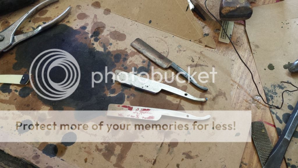

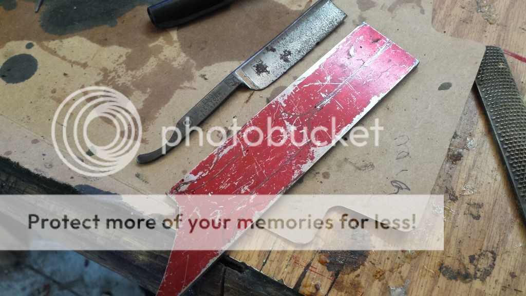

I used a old razor I had laying around for a template, but added a little of my own flair on it. Now that I know I can do it, I will be making some of my own design next, here I am transfering the blades to the scrap piece of 01.

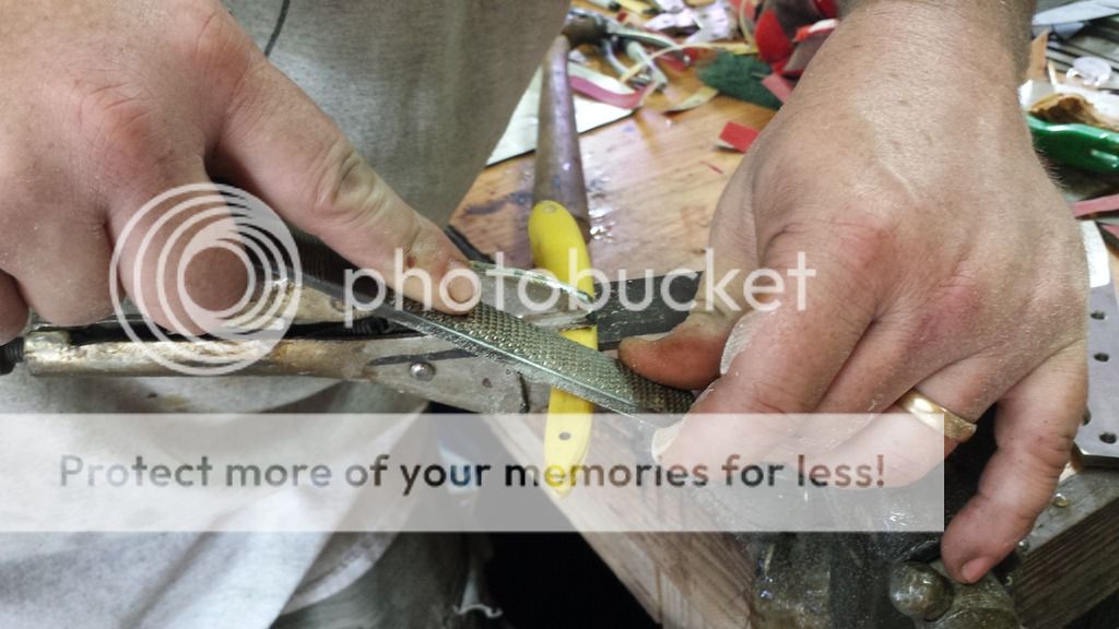

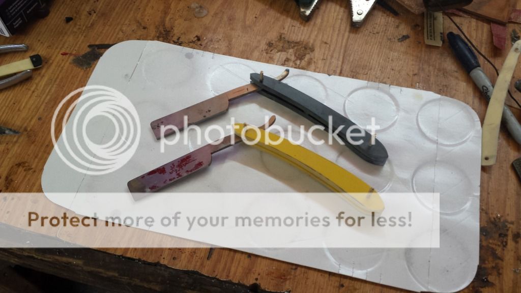

Next, I cut out and profiled the blades, also rough cut the handles and drilled some holes, before I knew it, I had some rough working models.

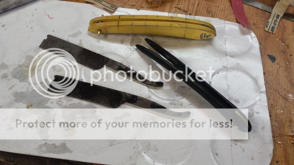

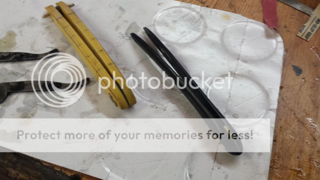

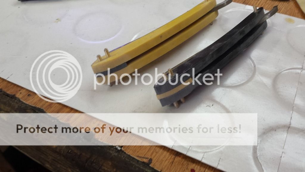

After that, I made the wedge pieces on the back, I found out the this makes the open and close function of the blade work correctly or incorrectly. I interchanged the colors to show off a little detail when completed.

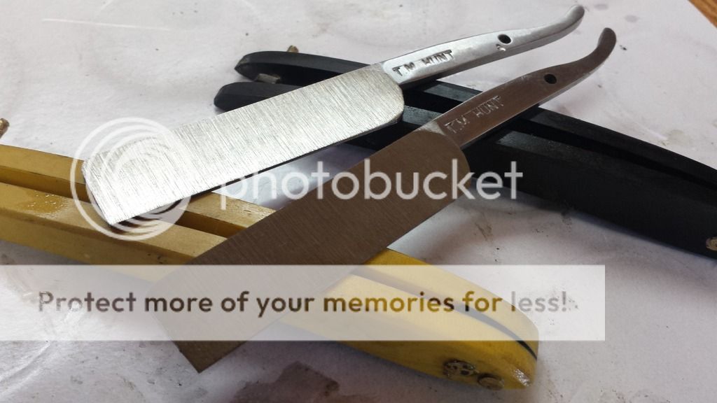

Hollow ground the blades and stamped them with my mark.
So I fired up the heat treat oven and it gave me some time to taper the rear wedges and start contouring the handles.
Got the blades heat treated in that time.

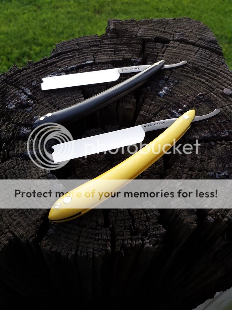

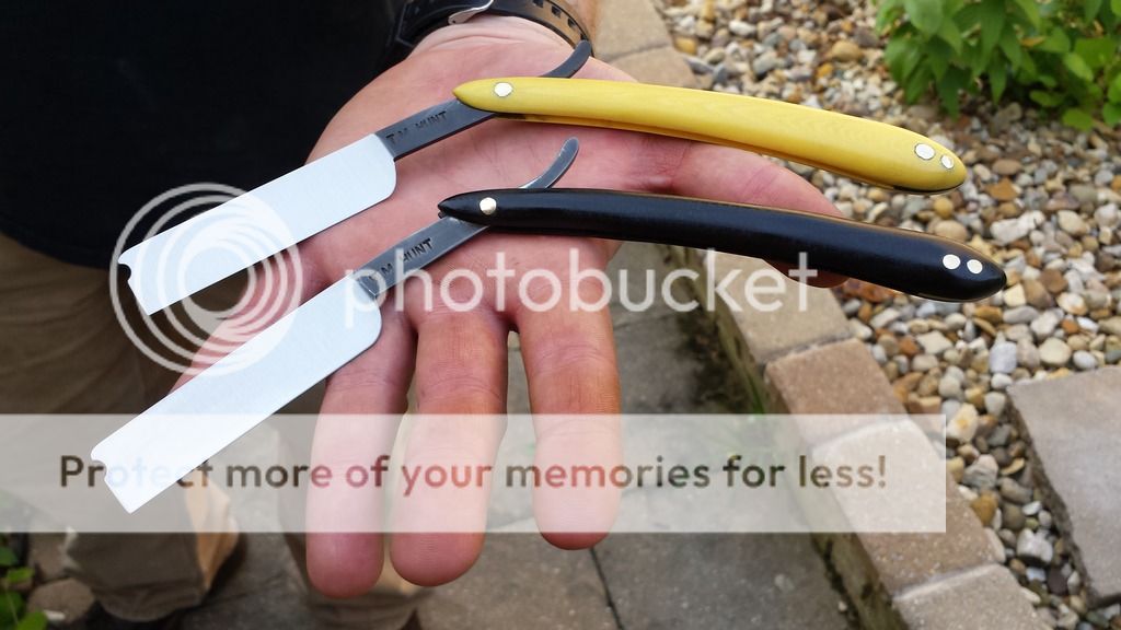

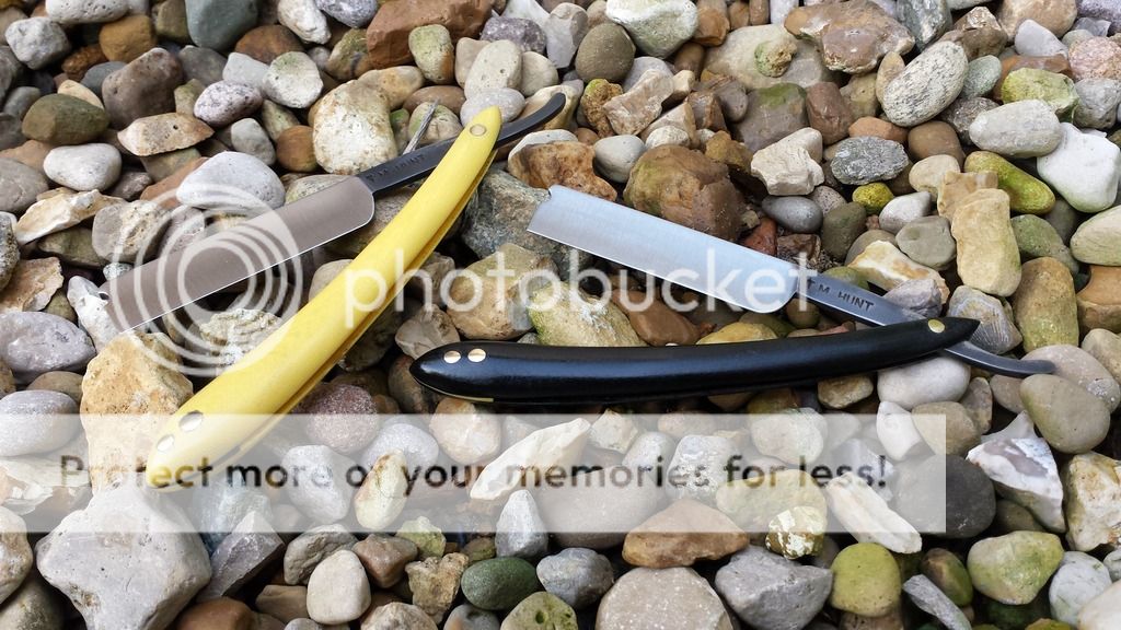

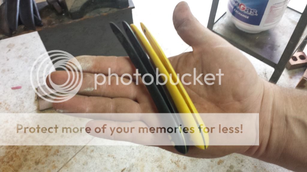

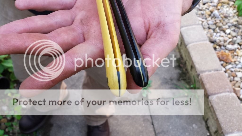

Final grind and assembly, and peening over the pins and here we are.

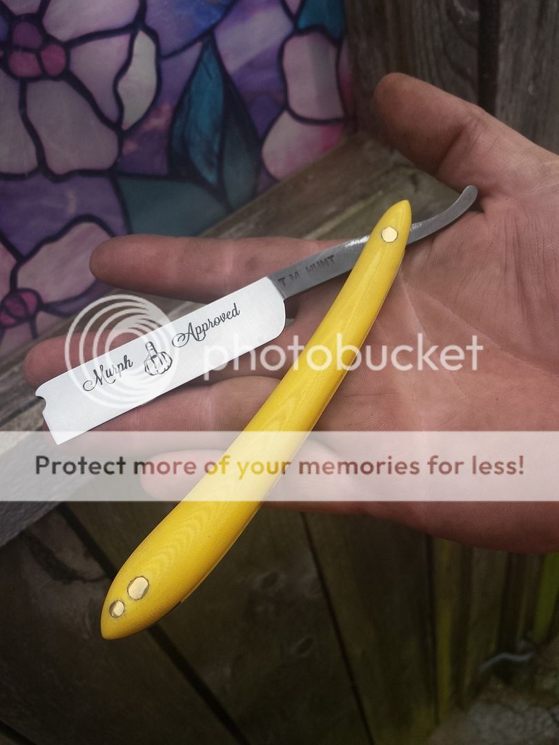

I even managed to put a little personal touch on Murphs, lol. For those of you that know him, you will totally get this! :-)
Overall, I am very pleased with how these turned out, and I had a blast making them. There will be more and other stuff like this in the very near future. Thanks for looking!
