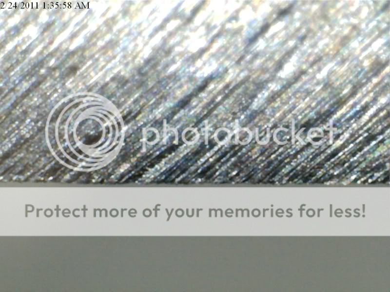

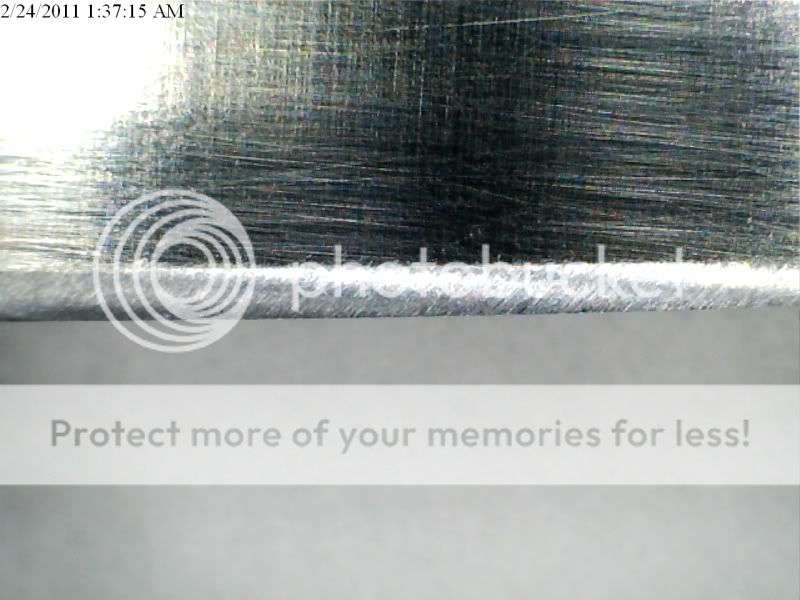

maybe i can help out. i just used a "coarse" stone (i think it's around 200-300 grit) to sharpen my spyderco centofante 3 (VG10). here are two pics of the edge under magnification. my microscope is rated at 20x-400x.
the first pic is around 40x:
the second pic is around 375x:

jim, if you were to finish that edge (strop on leather or slotted paper wheel for example) that would take off any points that might break off during use and make the remaining points sharper and more durable.
i de-burred the edge during the sharpening process and afterwards i did a few swipes on copy paper to clean off the edge. if i get a chance later on tonight i'll run the knife on the coarse stone again (maybe i'll use a coarse diamond stone instead) and i'll take edge pics of the burr, de-burred and before and after stropping on newspaper.
jimnolimit, I meant to respond to you earlier. Fantastic images my friend!
I think much stronger magnification is probably necessary to explore the edge irregularities (particularly those areas between the high spots).
Looking at what you provided, it is evident that you are quite proficient at sharpening! Thanks for sharing. What grit is your "coarse" stone (or what make and model is it)?

thanks.
im not 100% sure of the grit (maybe 200-300) of the stone i used. i have 200 grit diamond that i'll run the knife over later to compare it to. if i get a chance i'll see if i have some coarser sandpaper (maybe 80-120 grit) to exaggerate the "micro serrations" and give us a better pic. i'll also try scoping the edge at different angles to get a better pic.
