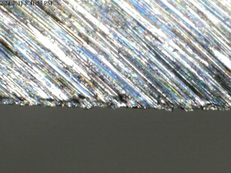

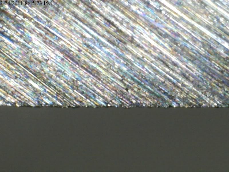

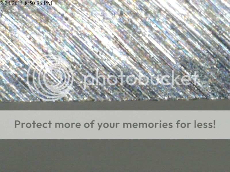

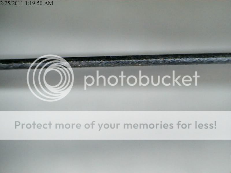

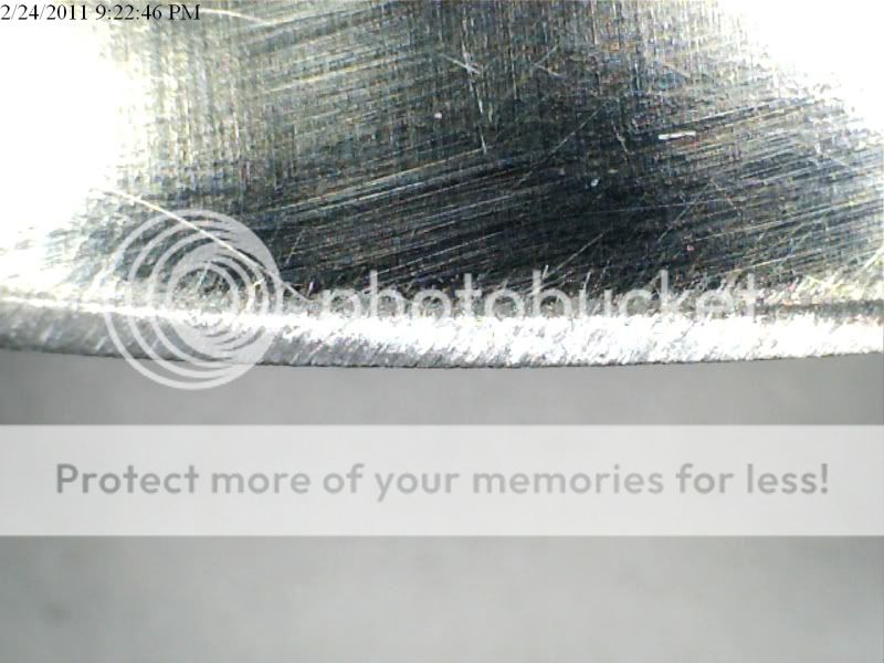

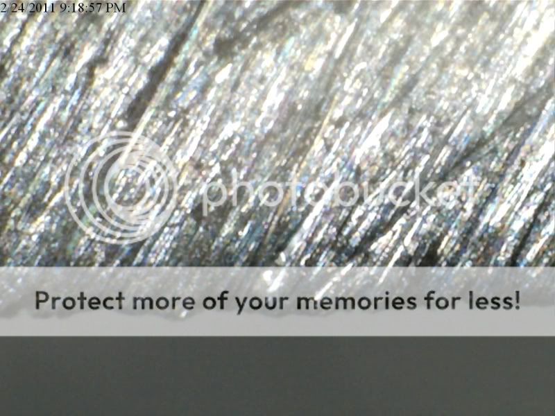

ok, i just ran my VG10 spyderco centofante 3 through a bunch of coarse grits. i used 60 grit silicon carbide sandpaper, 200 grit diamond, 400 grit diamond and 600 grit diamond.
the first pic is the edge with 60 grit @ 40x:
this is 60 grit @ 375x:
this is 200 grit diamond @ 375x:
this is 400 grit diamond @ 375x:
this is 600 grit diamond @375x:
Thanks for the images. Did you notice that horizontal feature in the bottom left of your work in this image? I think it may be present but harder to see on the right side also.
Jim, Thanks for the edge leading photo #32. It looks straight to me . Somebody has some good sharpening skills . In Dr. Verhoeven's studies and photos I've seen the 600grit edge look very jagged but then became very refined after a few passes on a leather wheel. So, those make a huge difference. DM
your welcome.
there is a chance those features (i think) are dust/micro debris, but i can't really say for sure. taking those pics are a slight pain because i have to wipe the blade off alot to get a clean shot. any micro debris will show up fairly large. i will give you an idea:

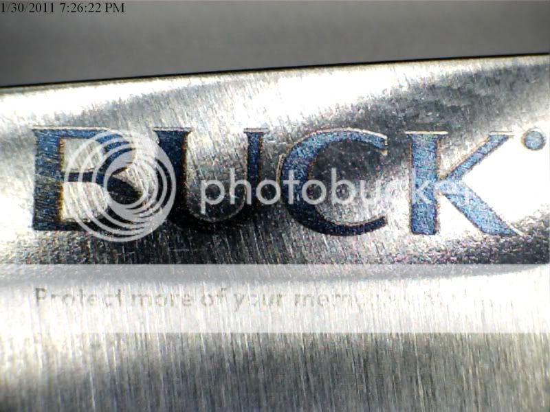

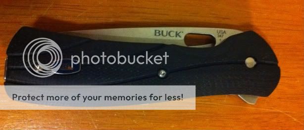

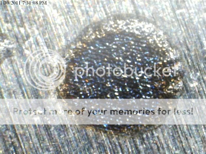

here is my buck vantage pro:
here is the name "buck" that's etched on the balde at about 40x:
here is the small dot in the upper right-hand corner at about 375X:
