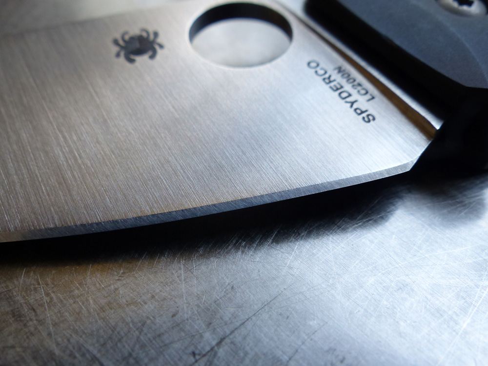

I have that diamond stone as well and the edge coming off it is very coarse / aggressive. Only the diamond are like that. A 220 or 240 grit
SiC is not so coarse. And Norton labels it a medium. Again, only the diamond is designated different. But extra coarse, humm. DM
That's because of the grit protrusion. Since diamond plates have the diamond coating the surface, they stick up higher than the same grit in a vitrified or organic bond, and so cut more aggressively.

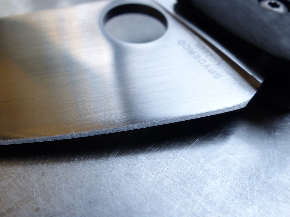

It's not perfect but I love the way this came out. Sharpened up to 280 grit on the lanksy stones.
Here's the edge under a microscope!
Bonus pictures, because microscope.
Cheers.
I tried #120 silicon carbide sandpaper.
Edge at #240 (silicon carbide stone).
The edge by #120 sandpaper was little too rough for my taste.
I will try #180 later.

But the primary bevel was supposed to be done at #220, and from the scratch pattern, I guess it is somewhere around #240.
That's a very nice job. I'm thinking the only 150 grit stone I have is the coarse side of my IB8, India. What was the grit type you used? Thanks, DM
N690 sharpened at #150 Venev diamond stone and stropped lightly on leather with aluminum oxide 3 micron.
Magnified at 30x.
There may still be some burrs left.
It should have been refined a bit more I guess.
But it cuts very well.

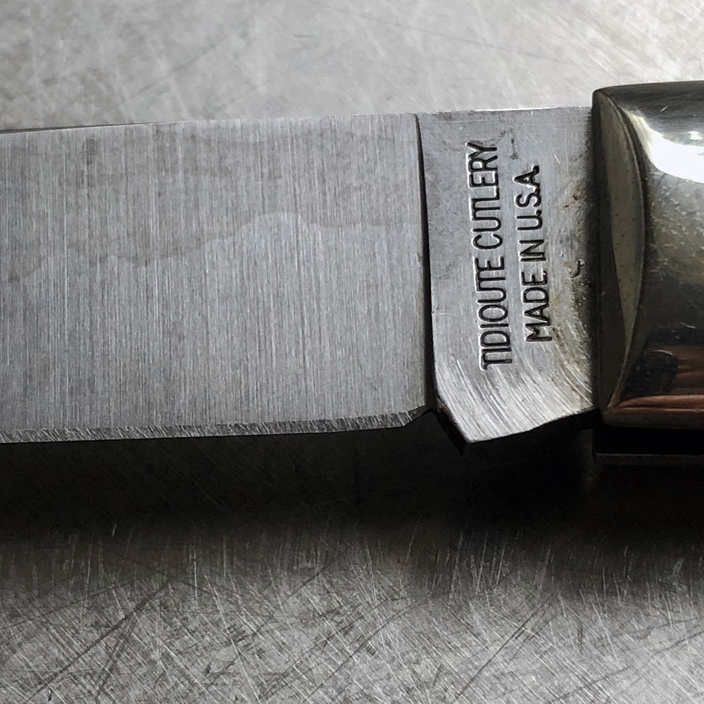

507E8C4D-7C0E-4934-9A92-BBAFD7A87152.jpeg When at work I keep a Metabo cut off wheel, that is too small for the grinder, in my pouch for quick touch ups.
Not sure of the grit but it leaves a fairly course finish.
Most times a few swipes will bring the edge back nicely.
