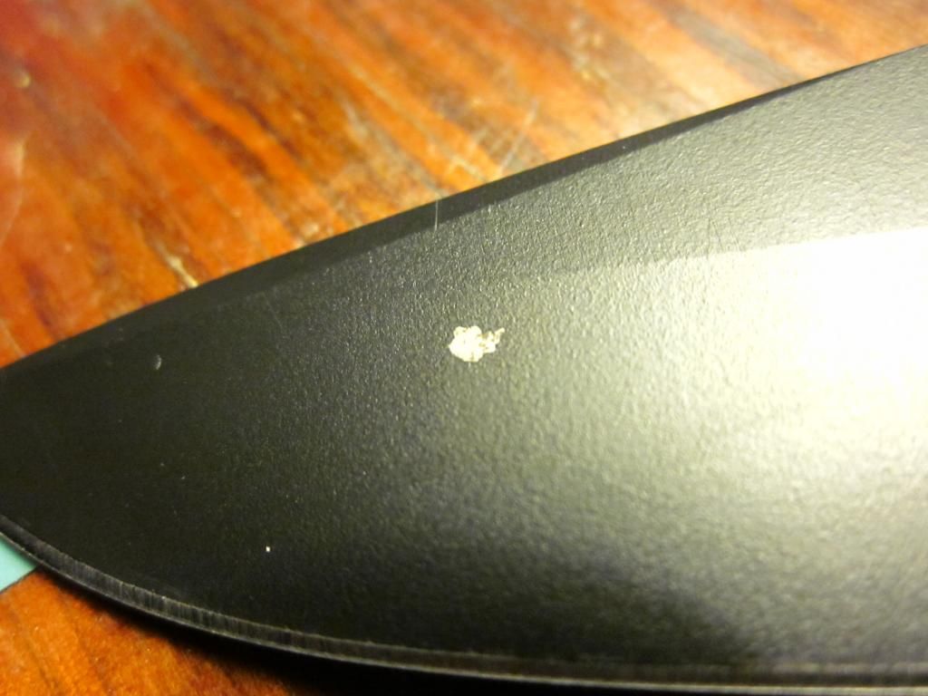

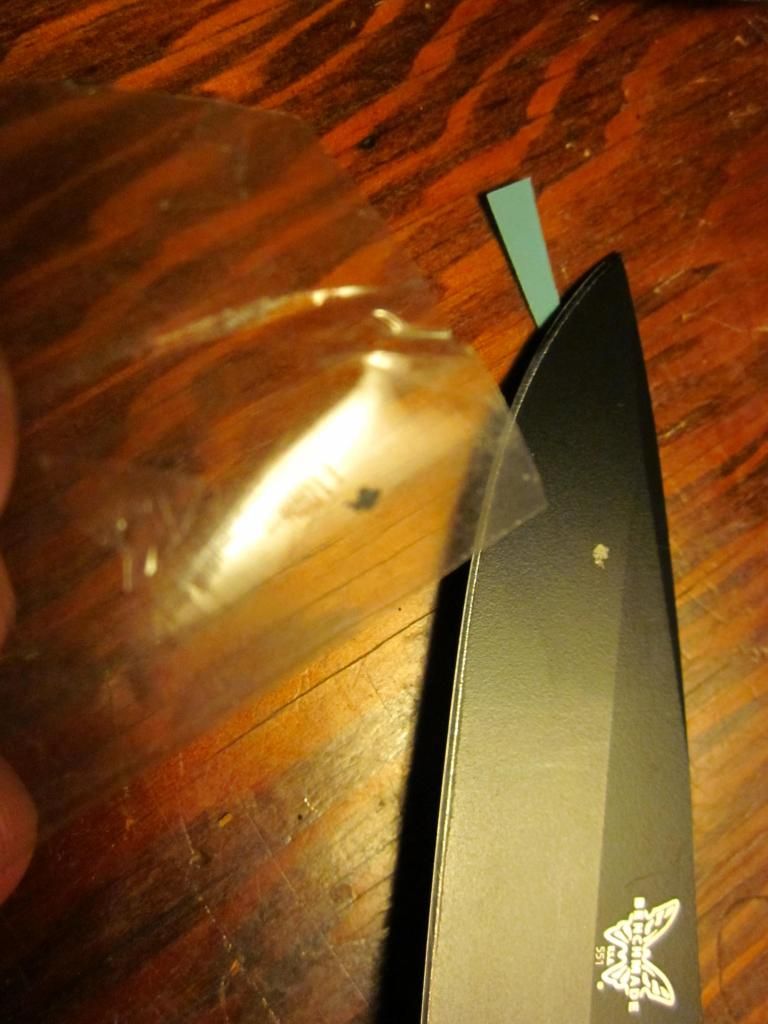

It was being sharpened on a EPA and when the tape was going to be replaced, guess what happened to the coating? Really displeased to say the least. And this is a LE Grip, with M4, and a LE number.
Great advice from above. Looks like it may have had oil, grease, etc on the blade before the coating was applied.
Called them. Same thing was said to me, the coating isn't under warranty, I can buy a replacement blade, but it won't be in M4, or have my LE number on it. I guess this knife will become a user then.

That sucks! If I might suggest, try and cover the scratch / chip with a gun bluing pen or liquid gun bluing or anything really.
Not only for esthetics but this will help prevent corrosion from forming on the uncoated CPM-M4. Moisture and sweat get trapped more easily in cracks and such unlike the edge. Oil will work too.

next time use painters tape! lol.......
