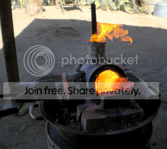

Here’s my cute little weed burner rig. :) I posted it on another thread, but thought there might be some general interest in it.
The refractory is 1 inch high density thermal blanket saturated with cone 10 porcelain slip
The aromatic cedar splints make for a nice rich fire.
For forging…
AND,… heat treating with the muffle insert…

Tai... I had a weed burner set up for about 2hrs and then took it down... the flames where shooting out 1.5 feet front and back. I wish i had known you better back then. Never thought about spacing the burner from the port and venting from the top, too. What is good about this set-up is there are no regulators needed. It looks scary as hell but it is pretty safe. I mean you can use those burners all day... that's what they are made for. No more dangerous than a BBQ.... well okay mabye a little more dangerous... but I've seen WAY more scarier home made LP forges than that.

I was wondering what size muffle would be good and how large should the ID of the forge be with that set up?
does the muffle just aid in even heat?
Yes, and you can create reducing atmosphere inside by putting a piece of wood in at in the back. I also use a splint in the outer chamber to shield the muffle itself. The muffle is a little extra long and sticks out the back to make room for the wood chunk inside. If done right, all you get is a little patina, but no scale or decarb.
You need enough space for the heat/flame to circulate around the muffle pipe. If your forge cavity is too small the burner flame hits the pipe too soon and you get inefficient combustion and hot spots in the pipe itself. The same goes for using a muffle with a coal forge... if it sits directly on the coals, you get cold spots. The weed burner suits a muffle pipe set up well because the flame isn't as concentrated but just as hot.

The refractory is so efficient that the cans never get hot. It's also such a nice light weight refractory that it heats up and cools down in seconds. So, you can turn it down between heats to save gas, although it's very efficient even with out doing that. It's nice to be able to bump the heat up or down so easy in general. It’s almost as “responsive” as a solid fuel forge.
Yes, the back of the muffle is plugged with a small roll of the refractory.
