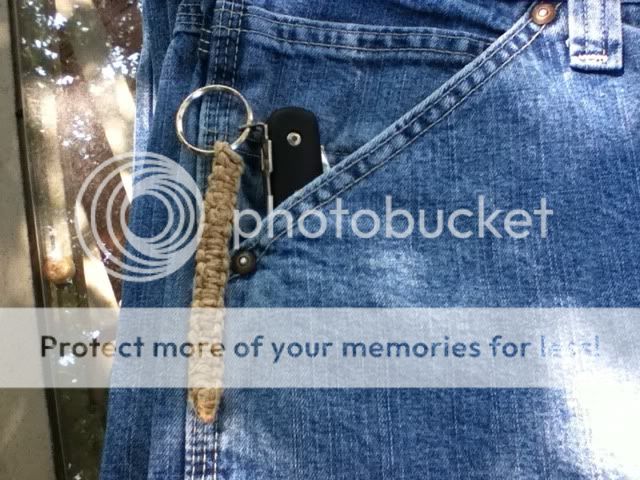

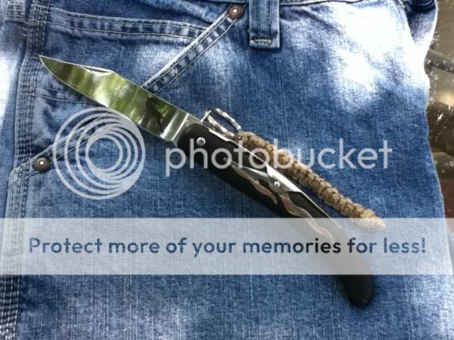

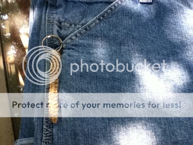

My only complaint when I first got it was how to carry it, it my pocket was a pain as it was too long to be comfortable. I carried vertically next to my wallet in my back pocket for a time, but really don't like anything buy my wallet in that pocket. So, I added a lanyard to the ring and hook it over the lip of my pocket. The added weight of the lanyard keep the ring from slipping back over the lip and down into your pocket. And, if I found myself in dire need of some cord, I can use the lanyard without loosing function of the knife. The lanyard also make the grip feel fuller and more secure as I grab it and the handle together in use (the specific knot pattern lays flat against the handle so it's not awkward at all).
Pics
Great user, that's held up to everything I've thrown at it, still sees EDC use from time to time as well:thumbup:
