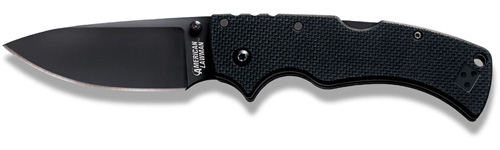

So I ordered one of these today, and I'm really excited... Does anyone have one of these as well? If so, what are your thoughts? I'm really impressed with cold steel's triad locks (I'm not a fan of liner locks) and for about 50 bucks on Amazon I couldn't say no.
This will be my first folding knife, and I'm crossing my fingers that it will be something that will last a loooong time.

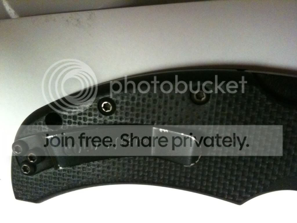

I was thinking of doing this myself.If you could post any pics of the results,I would love to see it.
I'm not much of a "picture" guy, so I did my best with the i-phone.
I sanded under the clip up to the 2nd screw. As you can tell, the screws are a bit shiny after the sandpaper treatment.

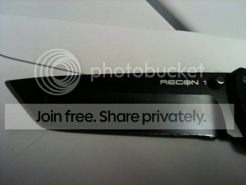

An overview pic. My photo skills are weak.

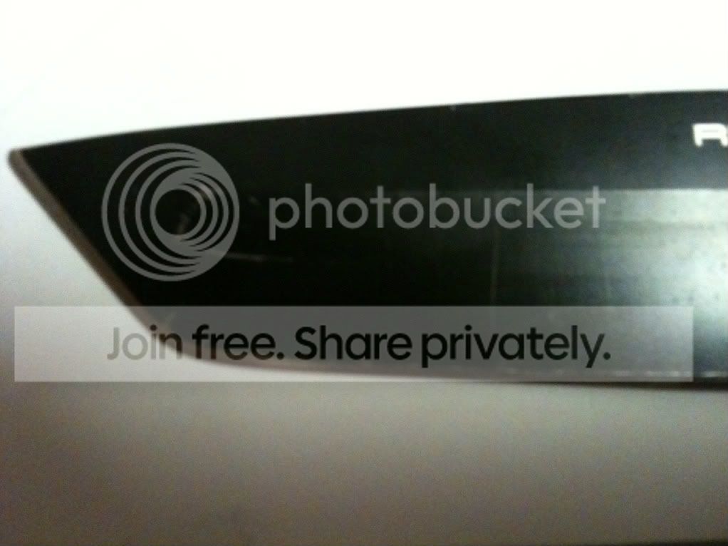

Anyways, I used a work sharp knife sharpener to get the convex edge. As for the 2nd tip, I first used a sharpening stone (coarse side) to grind it a bit. The WSKT took care of the rest. Careful though, the WSKT can roll your tip if you're not careful.
This picture sucks, but hopefully shows the 2nd tip grinded down a bit.

To any and all who are going to sand down G10, please wear the proper respiratory as G10 fibers can and will cause serious lung problems. A simple mask will not suffice your going to need an aerator mask probably about $40 at home depot or lowes, but you need one that protects against both particulates and fumes. G10 dust is nasty stuff.
This is definitely the safer way to do it but for the small amount of sanding you'll be doing you will be fine with a simple mask and doing it outdoors.
If you are competent enough to take your knife apart you can just sand down the scales under running water with a handkerchief on for good measure.
Dust problem solved.
