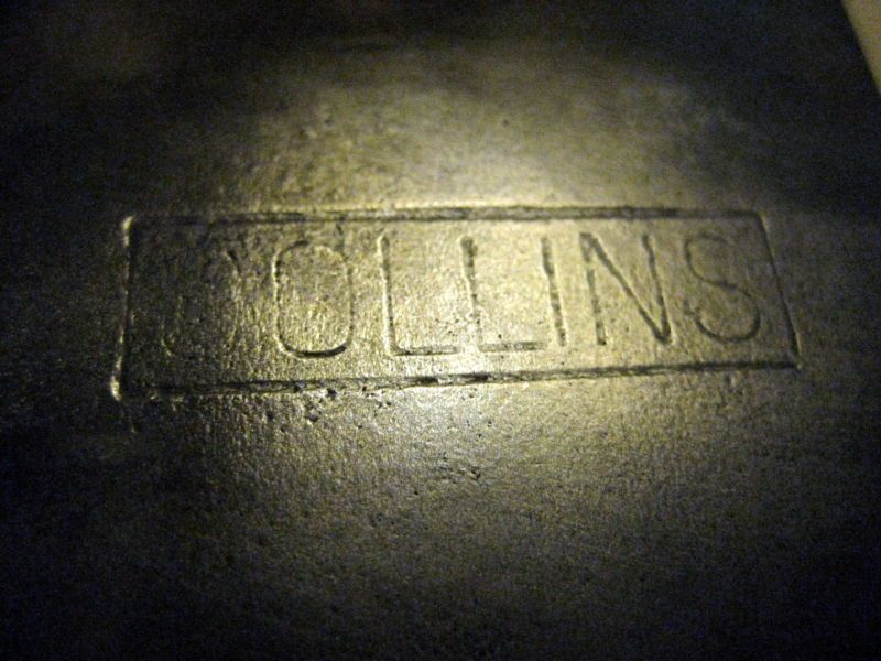

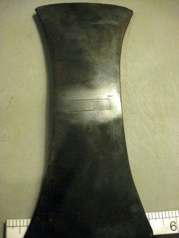

Does anyone have any information on the Collins logo with the rectangle around it? I saw the picture of the Boy Scout hatchet caption dated 1926-1932. Was that the only years for that logo or was it used for a long time.Can it be narrowed down to a decade or so? Thanks just picked up a pretty nice double bit and half the fun is learning about it.

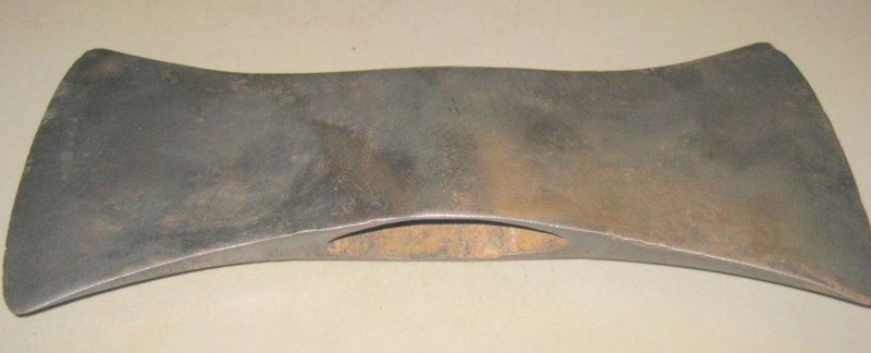

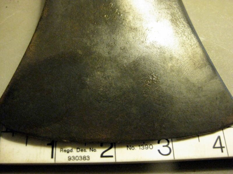

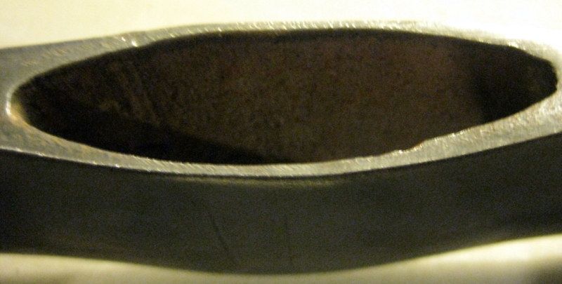

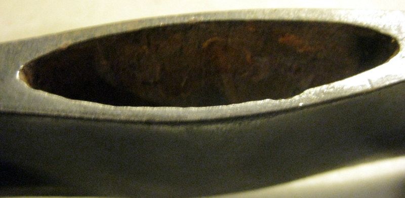

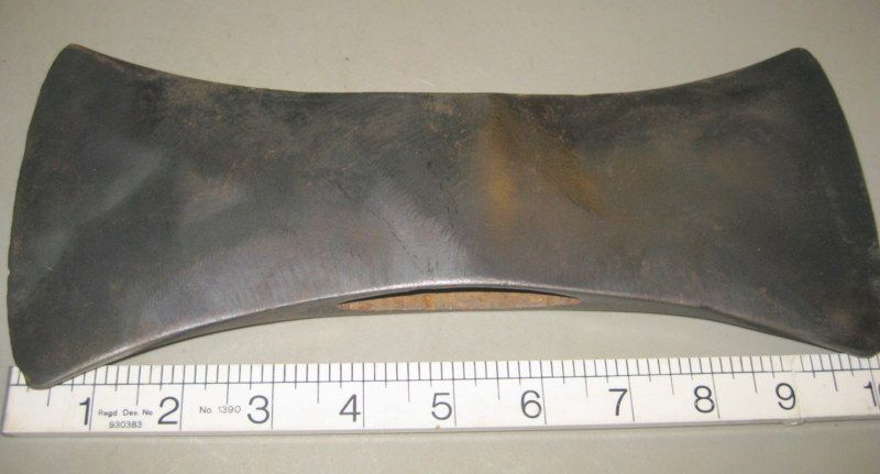

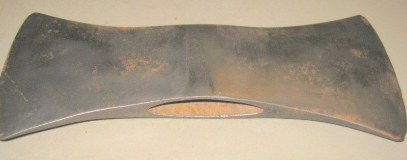

Complete newbie question I know, but here goes. I just bought a Collins double bit axe. Which way does it go on the handle? One side of the eye is slightly larger, that's the top right? The curve on one side is slightly more but that is opposite the large eye side. Any input is appreciated. Thank you!
Can anyone tell me anything about the age of this stamp

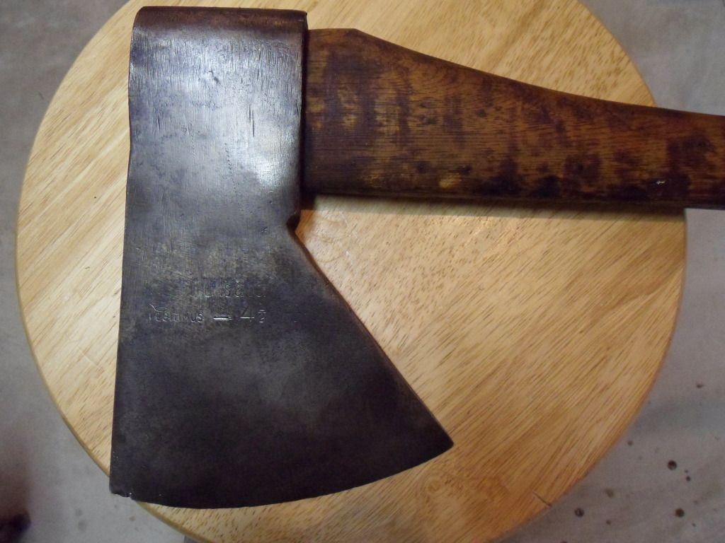

hope this helps:)
Thanks :)
I think that in the first pic that its upside down, but I could be wrong.
We've had similar debates about these style axes before.
Maybe someone else will be around soon with a second opinion.
I believe that you are right. The wider side of the eye was the top of the head. This allowed for your wedge to work for your axe. Giving it room to expand on the top side, providing a wedging action.

Yep, larger side of the eye is intended to go up. But with that pattern, you could reverse it. I'd just hang it with the longer tips up. And when those wear down then hang it the other way next time.
Thank you all for your input. I'll post some pictures one day when it's back in shape. I just want to do it right and return a piece of heritage to a useable state, and learn a few things along the way.what are your thoughts on handle length?
