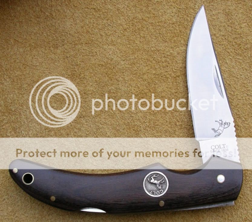

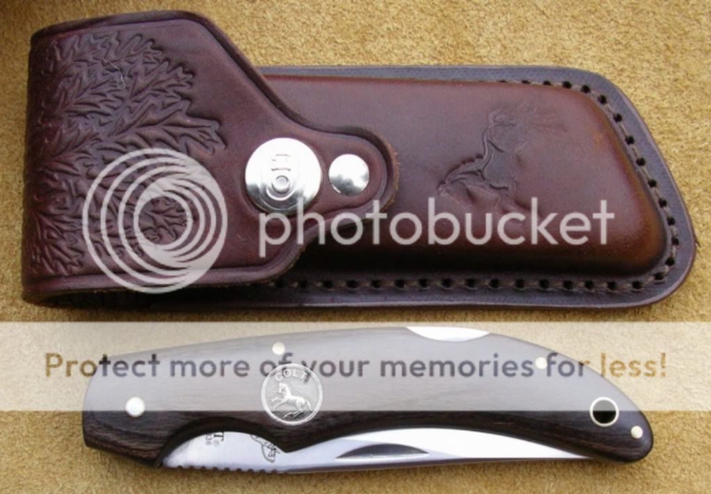

I have a Colt 4 5/8" LB with leather sheath. CT0016/Stainless/China. hardwood handle. Very Nice !
i'll get a pic when it stops snowing.
roland
Here ya go:
roland

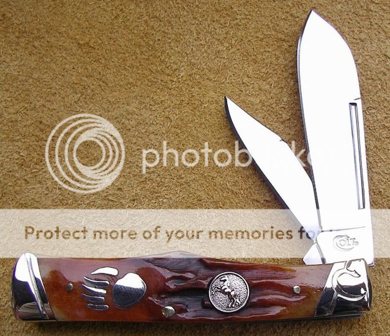

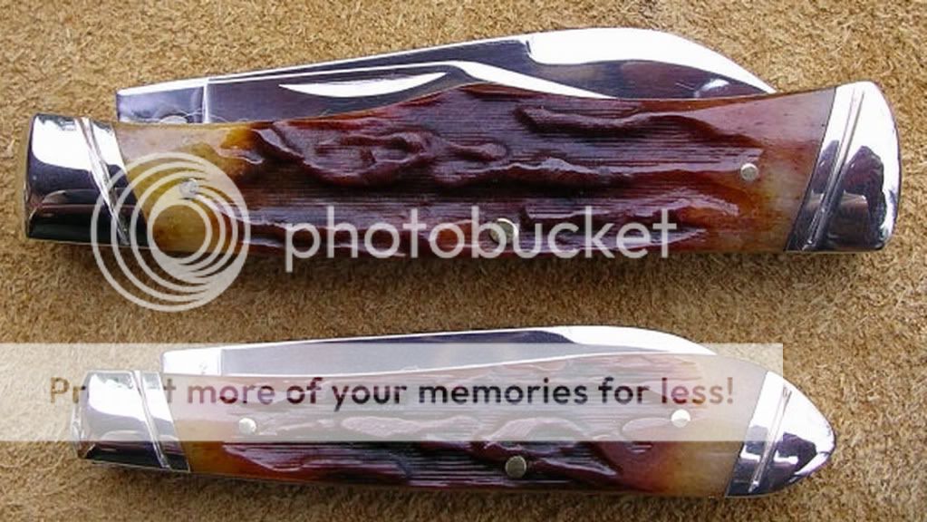

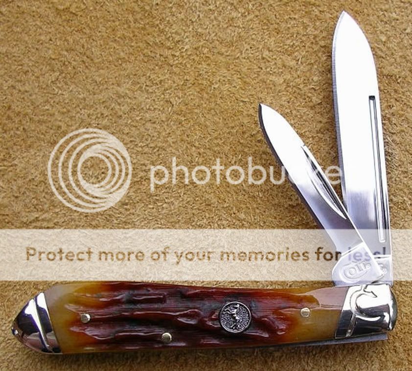

here's 2 more Colt folders: 3" Dogleg Jack and 3 1/2" Gunstock. my pics don't show the really dramatic swaging on both sides of all blades.
Pile side:
Pretty nice, eh !
roland
