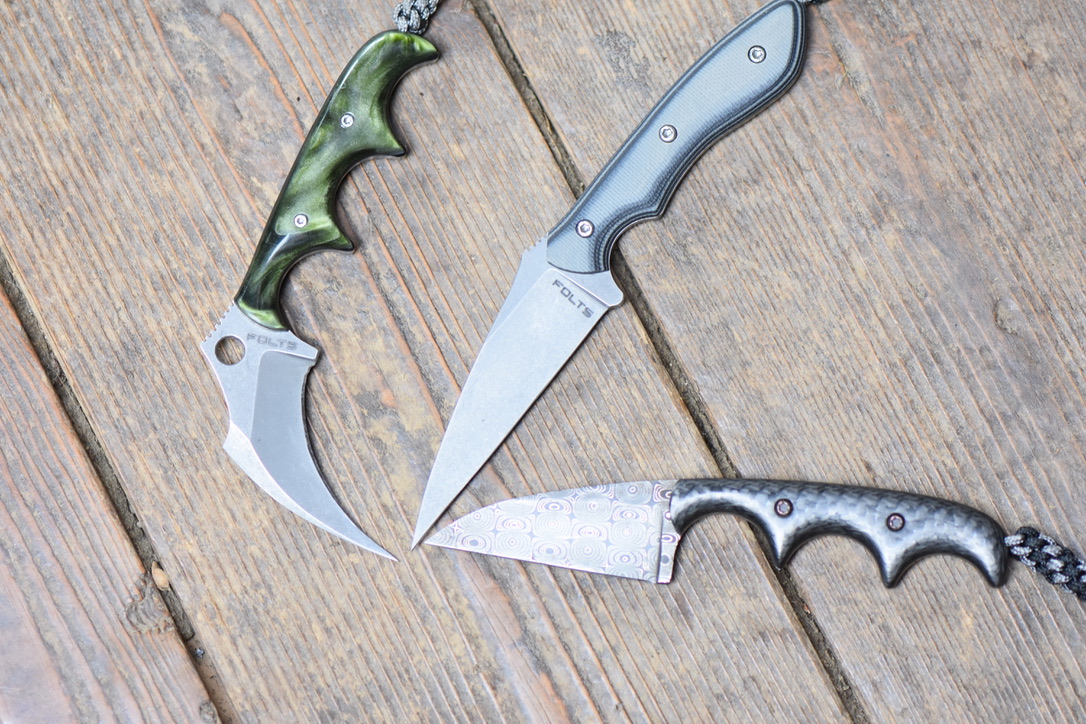

Hi everyone,
ill try to keep it short and put all the details at the end so you may decide not to read them.
1) What steels are comparable or better than K390? (edge holding > grain structure/sharpness > toughness > rust resistance)
2) What do you think about the lanyard solution on Folts Minimalist (it has a cut groove at the end instead of a hole. In my design is a hole because i think its easier to make and the scales can be weak with a groove)
3) Would anyone be able to make a me a custom knife (see below) for a reasonable price?
My design is very much based on the CRKT Minimalist that ive been EDCing on off since 2012.
The idea is to drastically improve the steel (currently leaning to K390) and customize several other aspects.
ideally made in europe to keep shipping costs at a minimum.
I took some time to put my ideas to a virtual 3D paper:
Feel free to give me your opinion.
EDIT: I wrote much more about my decision, each change and some aspects of making it (steel, price...) but it got too long so if youre interested in that you can read it here: http://freetexthost.com/i6ghyyc05z
Thanks everyone!

Your first question has a problem because almost all other steels will exceed K390 in some respects and not others. I'd argue that you need a balanced steel for strength and toughness. Those fine tips are what makes the Spew and Minimalist family work so well. You don't want a tip that will break, and you don't want a tip that will bend.
These knives are not meant to be heavy duty, but detail knives. How you use the knives is more important than the steel.
On the second question, you can look at the Folts custom and see what he does with the lanyard hole. It works fine for me.
Your third question bothers me because you're asking a knifemaker to copy Folts' design. Nobody should do that.
Folts uses CPM 154 a lot, which is a really good steel. He also uses damascus, which I know nothing about. Why not just get one of his customs. They are not all that expensive and they are much better than CRKT.
I have a couple of Minimalists, I carry and use them from time to time. Folts customs come up decently often on the exchange for about what you would pay a maker to copy his IP. Changing the tail fob to a lanyard is actually a sticking point in my eyes. The Minimalist fob sticks straight out the back and is made of a stiff wrap of microcord, that's what makes it feel like an extension of the handle. Changing it to running through a lanyard tube means the fob will be much more floppy and tend to ride up on the spine. It may not be a big deal, but it would annoy me.

Don't just copy somebody else's work. I'm not sure a knife maker here would want to do that for you.
This. I expected even more people to raise this complaint as i had a similar thought when i came up with the idea to customize this design.
Still how else do i find out if theres people willing to make it out of some crazy steel.
I prefer openly saying its using that minimalist as base than lying its my own design.
These days its hard to come up with a completely original yet still practical design. And designing it on pc without touching it means my expensive custom knife could be uncomfortable as hell. Better start with dimensions i can measure and be confident itll fit.
I did want some changes on the design (geometry, guard, spine...) and i drew the whole thing in 3D from scratch, which took me way too long thanks to bugs and my lack of experience.
In fact ive been working on it even after i posted this and still come up with adjustments.
Yesterday i changed the blade shape making it taller and tilted so that i could reach a cutting board with enough knuckle space, hopefully making the knife more versatile. It changed the look significantly but even if i change the look completely i still wont deny its heavily influenced and based on the minimalist.
Today after feathersticking for an hour i started to think about some handle changes as well. Its not too good for that specific purpose... Theres a high risk of ruining it though.
Part of me knows the knife is only so comfy because ive been carrying it for 7 years. Had i worn a different knife maybe id want a custom in that shape.
Anyway, i dont think a blacksmith making this knife should feel bad for it. Especially a one time custom. Every bowie, katana or whatever people request is a copy as well but the blacksmith is still the one doing all the work and making their own version of it.
