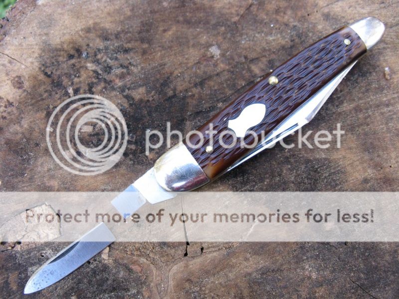

I take that last statement back. It appears the pen blade was stressed. I just opened it to see if it was straight, and it snapped right in two.
oh man! I am so sorry
i would be heartbroken if that were me!
definitely get it replaced if possible, i am not sure how you could make that a screwdriver, it broke before the thumb nick so how would you ever open it again?
I hope it works out for you!
Grind in a new nick if the blade doesn't sit too low (which it might).

I think it would sit too low. I looked back, and this first picture taken when all three knives Paul traded me arrived is the only one I have of the 236 with both blades closed.

I could replace the pen blade in your 236 Schrade Walden if I was in a location where I had the facilities to work on knives. I live in Kingsland, Georgia in the winter months and wil not be back in North Carolina until April 2013. I do not have a shop in Georgia. The stag and peachseed bone I have rehandled seen on ebay is the ones I have done the previous summer. Sorry I cannot help you at this time.
Just a bit of information on straightening a crooked blade. If it is bent from the tang, securely clamp it in a vice as close as possible to the tang. Then gently pull the bend out of the blade. This generally works. At least you break less blades. Herman
