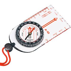

I have a few compasses and I usually use my Suunto M-3. Its much simpler and easier to use than the US mil compass from Cammenga. Not that the US Mil Cammenga isnt good, its much more accurate IMO if used correctly.
IMO a flat clear base compass with an adjustable declination is the best. Check out the M-3 and MC-2. Also similar compasses from Silva are the Explorer Pro and Ranger CL515.
As for needing to use it: Been plenty of times Ive used em, but usually during teaching. The times Ive used it in the field has usually been for practice. I usually follow the trails and don't bushwack, so using the compass hasn't been for any emergency use. But knowing how is invaluable, anybody going into the trails without knowing is asking for it.
+1 for the Suunto MC-2. It is my field compass. Very accurate and easy to use. Did quite a bit of orienteering with it this summer and fall.

You want a compass that you can adjust the declination.
Declination is the difference between Gird North (the lines on the map), and Magnetic North (where the needle points)
You need to know how to take a bearing, adjust the bearing using the declination, and then walk on the bearing.
A decent sighting compass with a mirror with an adjustable declination will not cost more than $40
