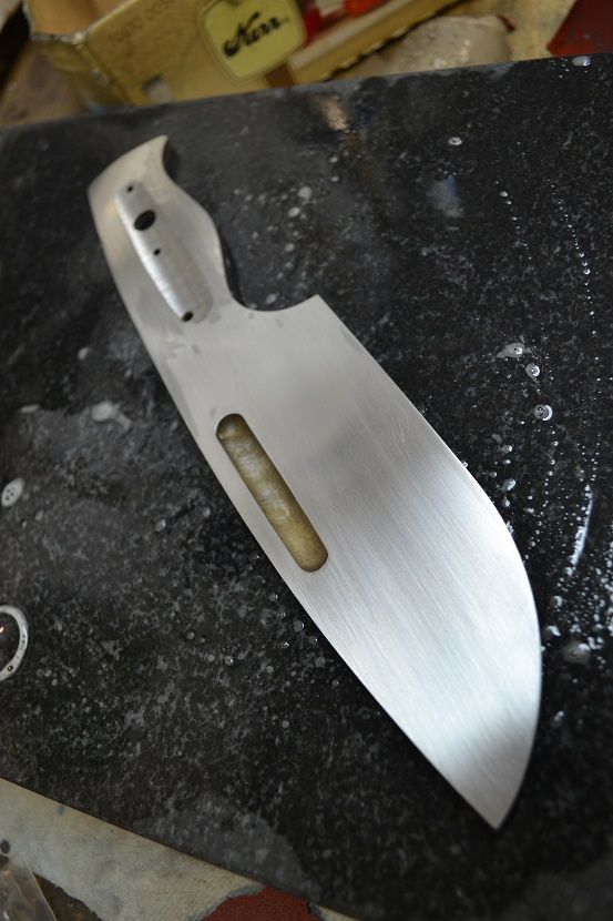

I just walked in from working on this one, a tricky compound hollow to "wrap around" convex grind. The convex wraps around to form the swedge.

This one was tricky... easier to do this style with a 1" wide wheel I hear. I'm really happy with the outcome so far! That's straight off the grinder.

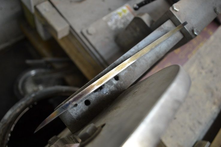

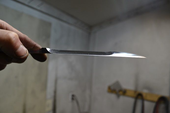

Deep dish hollow to thick convex...

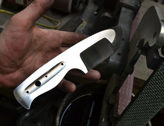

Lots of taper to the tang! I also hollowed the tang a bit to reduce weight. It's still crazy strong!

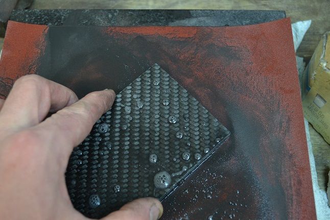

Lapping the Carbon Fiber flat. This CF is handmade in the USA. (steel is USA made too)

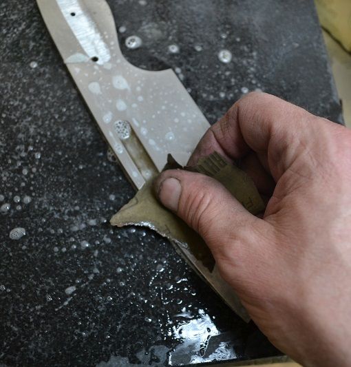

Clean Up on the Fuller
Flats Cleaned Up
