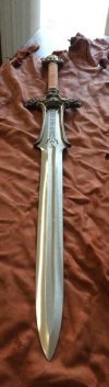

For sale is one of my conan project swords I made.
I worked with another fan to re-create a sword right out of the movie screen for our own collection. He had some plastic reference models of the guard and pommel and I designed the blade and engineered the assembly.
I started with blade blanks and created models and molds of the guard and pommel, then cast wax versions and had them made into bronze (cast solid with a void for the blade to slide through).
-Hand ground blade
-5160 spring steel (professionally tempered to 55RHC by PACMET)
-4" radius fuller
-8" radius hollow ground bevels
-Full tang with welded bolt for pommel attachment
-Engravings were done by a CNC Machinist
-Hardwood handle wrapped in dyed cord
-Total length of sword: 38.5"
-Width of blade is 2.25"
-Weight is 8.75lbs
Price: $1195 (includes shipping to CUSA)
Thanks for looking!

The problem I have is the weight of the sword.. it is extraneous. I am sure it has a lot to do when the fittings... I wonder if there is a way to make Conan's Fathers sword but again light and more Battle capable.
I agree with you, it is heavy compared to a historical, life-defending sword...by 3x! The blade is wide and thick (not much distal taper), it weighs 3.5lbs after it is ground. The bronze is about 4.5lbs.
This is definitely a movie-art sword. It is meant to look awesome and feel awesome. The POB is 4" of the grip...it balances great but has a huge presence to it. I've made a nice wooden plaque with a carved Conan logo on it to display mine.
I've been studying these swords for 10 years. I've never found a handmade, hollow ground replica like the one I made.
