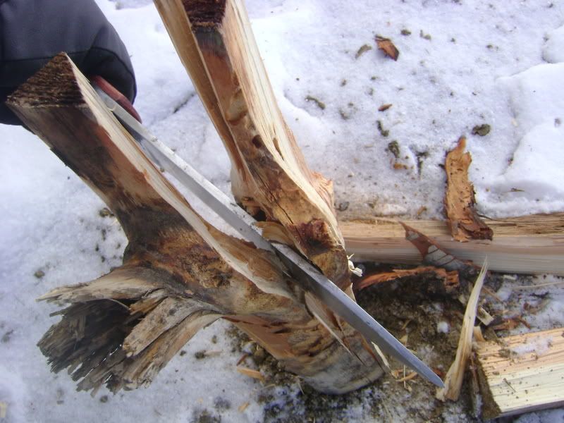

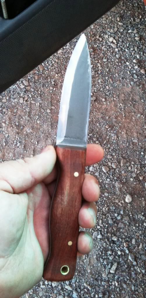

Got a Hudson Bay about 10 days ago. Took it out for some fun today:

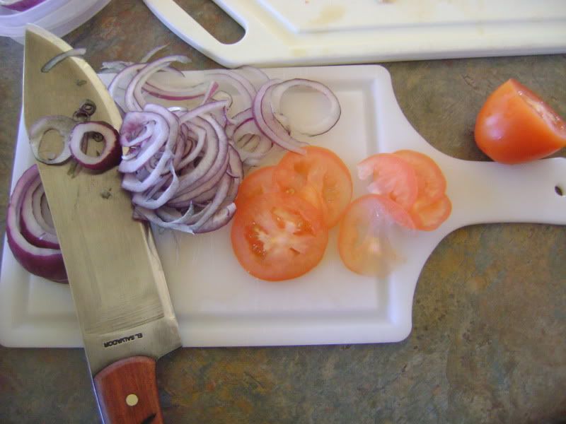

It's one tough knife, from what I can tell. It's also not too bad in the kitchen:

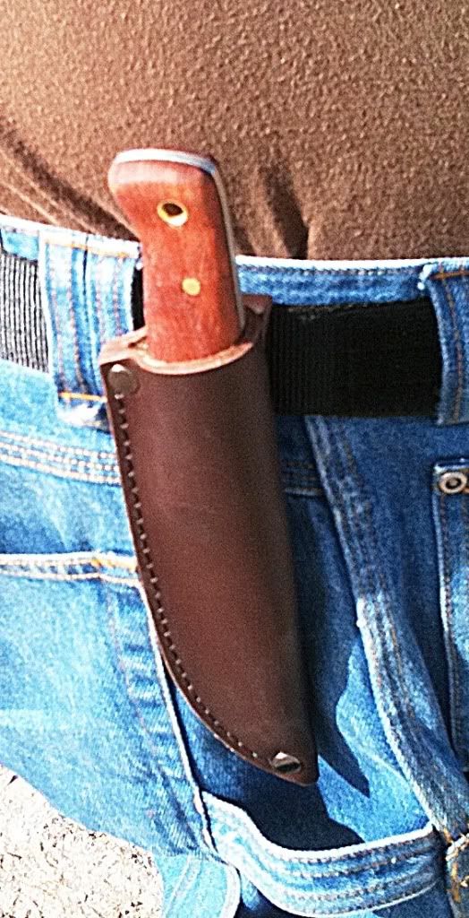

All in all, a great value. Randalljames6 is right, the sheath alone is worth the cost of the knife. I love the pivot system, it's great for cross-draw carry (too much real estate taken up on my right side by pistol and smaller knife). I have more pics, and a mini-review in the knife reviews section, for those that are interested.

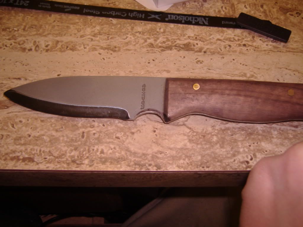

I just spent an hour filing on mine and I'm already liking the choil idea. I've got a long way to go (and I think I need to hit the hardware store for a more appropriate tool) but I like it so far. The Sharpie roughly represents what I'm going to remove:
Sorry for the weird color, the only camera I have charged up is the one that's been altered for infrared photography (no IR filter).
I flattened the grind some.. Mostly just taking it from a hatchet type convex to a scandi grind. But after using it today cutting and making fuzz sticks I determined I want it alot flatter. But like others have said i need to get some power tools ( like a belt sander) before I tackle this. It will never be the pocket chainsaw that my fallkniven f1 and a1 are but I thought it would be fun to try and tune it up some mostly just to try out the blade shape before I buy a custom bushcrafter.
You guys will like the 1/8th version alot more. Most scandi knives that are thick need to have a grind height of 11/32ths, and that was the problem with this one. If you take it up a little higher, you will have some great results.
