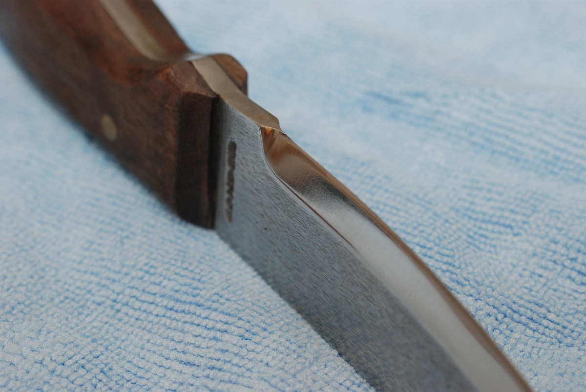

The grind on your knife Halberdier is much closer to the handle than it was on mine and some others if mine had been like yours I might not have gone to the effort to finish grinding that last section. The factory cutting bevel on my blade stopped at least 3/4 of a inch from the handle.

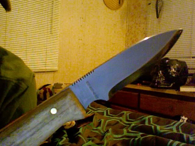

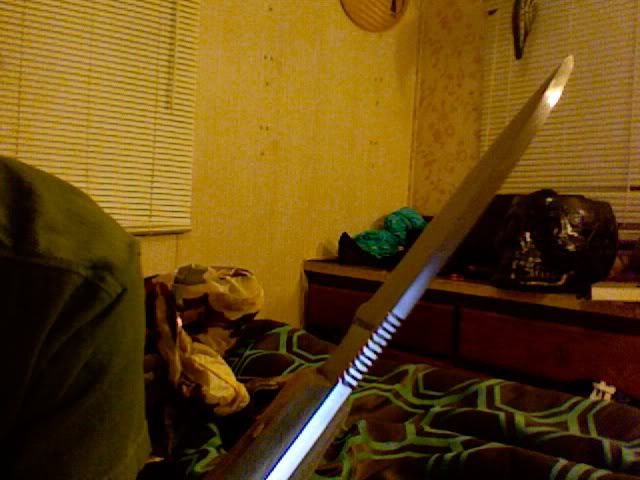

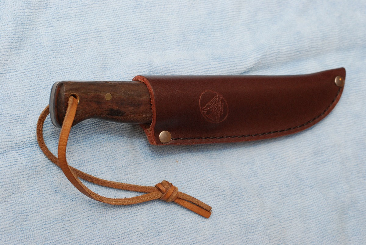

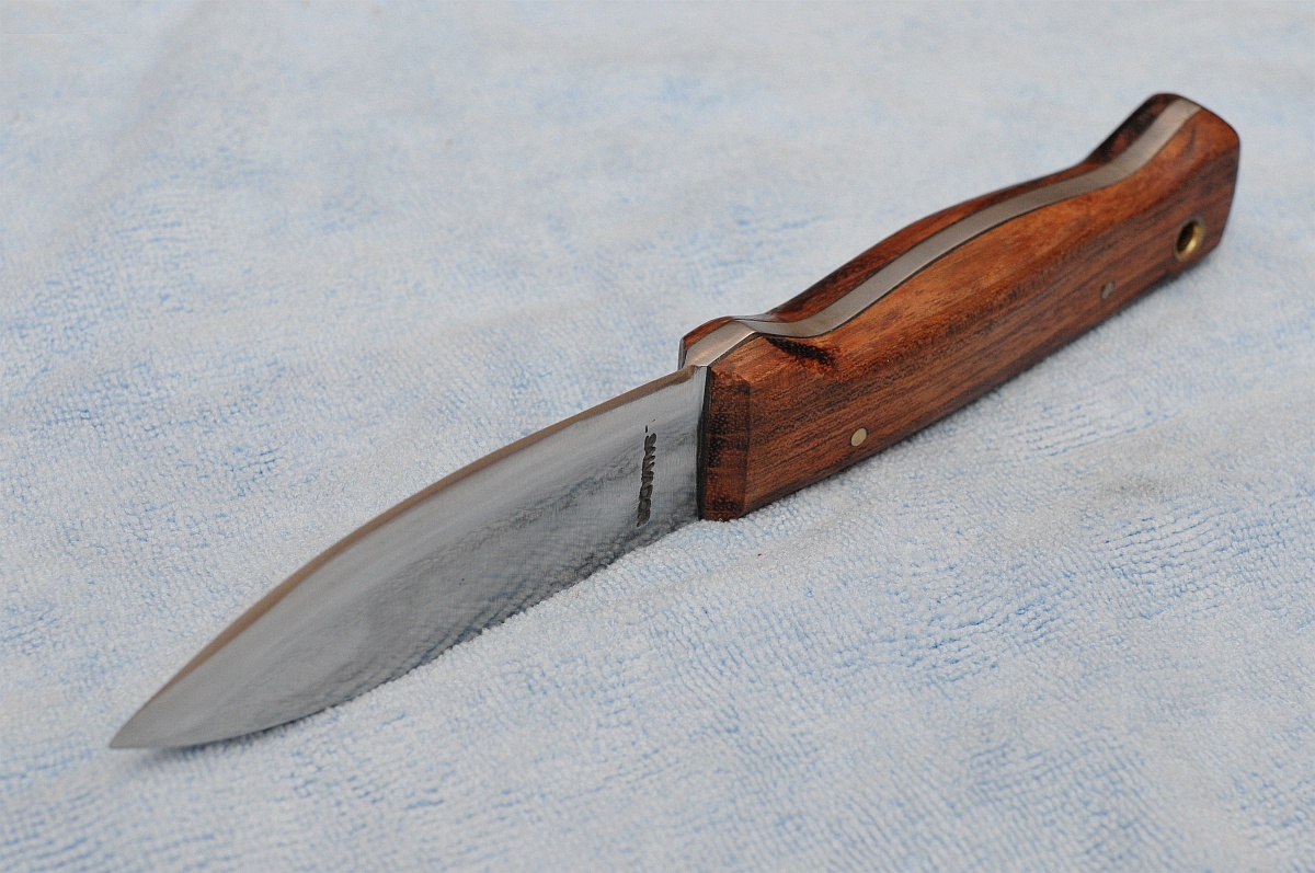

I forgot to post the results of my tinkering (crappy webcam):
It came out a little rough but I like it a lot more. I rushed the spine and it's pretty sloppy but gets the job done.
Just smoothing out the handles a little is a vast improvement.

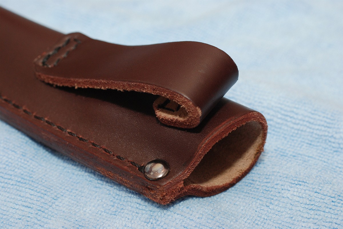

Ranger band.

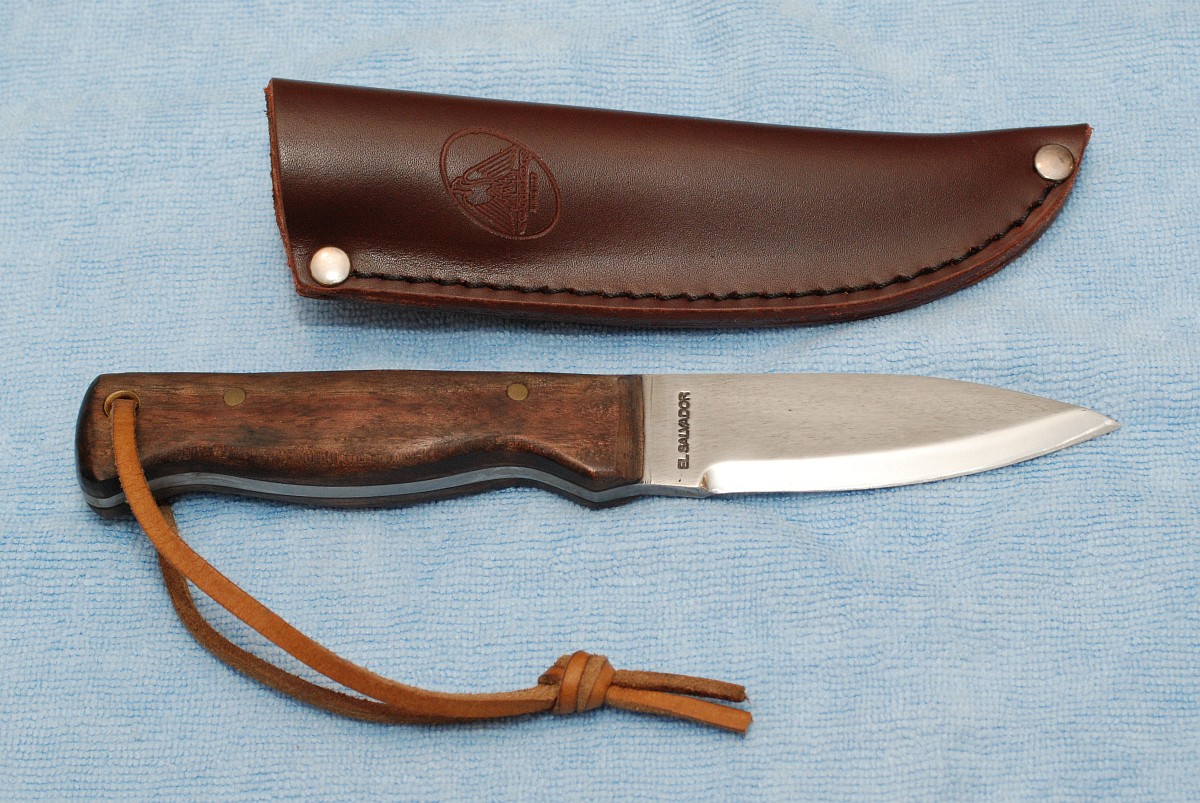

You could probably undo the stitching, peel it apart (its glued as well as stitched) then cut out a little bit of the spacer. Make a firesteel loop out of a small strip of leather the width of the piece you removed. Then re-glue and restitch it.![]()
