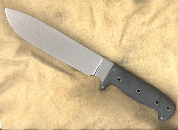

Ok, here is a crappy pic of two blades I am working on. The bigger one on top is forged L6, and will be my personal camp knife. Blade is 7.5" and is flat ground. Overall length is a hair under 13".
The other blade is a nice piece of Kevin Cashen's O1/L6 random pattern damascus in 160 layers.

Danbo, Those are mighty dang nice blades!! :cool: (where's the slobbering drooly emoticon when you need it?) Thanks for sharing. The big one appears to my eye to be a hybrid between a drop point and the shape of the very utilitarian Benchmade Griptilian semi-sheepfoot blade, which ain't bad pedigree to bring to the party. ;) :D It looks like it just begs to be used. Does that leaf-shaped blade on the little one have a distal taper?
It doesn't yet, but it is a long way from being done. The top blade is heat treated, but the damascus blade is not yet. Still undecided as to what handle slabs to use on the damascus one. The top one will be getting nice, thick green canvas micarta slabs.
