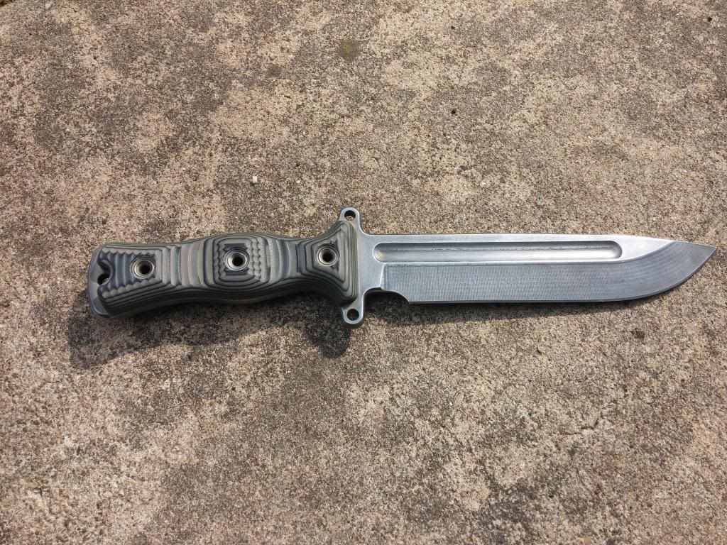

Hello all,
The coating on my tglb is showing some wear, which has a cool factor all its own--but, I'm eyeing it and considering a make-over. I've read some threads about this already, and I've stripped a couple of Beckers, so I get the basics and have the materials... however, I've also read that there is another coating/ surface between the coat and the infi (I think), so I want to handle this the right way...
Any suggestions/ advice? Thanks in advance.
Here's a pick of my tglb that I've posted elsewhere--just for kicks.
I've told you this before but I think you have one of the best looking black on black TGLBs out there. I mean the micarta is so dark and the blade finish looks really smooth.
Thanks Morgan, the blade coating is actually the tanker grey; maybe it looks smoother/darker due to use... that is surely why the micarta is darker--sweat and grit! Nonetheless, should I choose to strip, I'd like to hear from those who have before I begin. I plan to leave the coating under the micarta and on the guard/holes--just a naked blade, should I opt to strip.
Yes, after you strip, there will be a dark grey layer. You can leave it like that, or abrade it off with Scotch Brite or medium grit sandparer.
thanks resinguy--I've read about one guy who began with 150 grit, then moved on to 220... I was thinking of taking it to 400 grit? Anyone do this? Is leaving the dark grey layer preferable or not? From what I read, it seems to develop rust, and raw infi is more resistant.

Jasco strip away epoxy coat...scotch brite or steel wool the gray decarb like Highrisk advised...it is like the primer coat between the slick INFI & the epoxy coat and it does promote orange rust almost instantly...
I'd continue to steel wool until you achieve finish you desire...wet/dry sand your way through grits up to 1000, 1200, or even 1500 is good too ( labor intensive, but therapy to me )...I've done it both ways...
Just don't bust out the Dremel or bench grinder on your INFI...you may mar the finish and have to work harder to regain the glory...keep it hand to hand combat ...
You will be rewarded with a bad-a$$ tool which will be more dear to you IMHO....more labor = more special
Don't worry about "messing up" your INFI with chem. strippers & hand sanding, it can take it...but for safety's sake watch the edge & tip ( don't impale yourself when sanding )...that Jasco stripper can be a bit nasty too, burns like a sumb*t*ch and would probably blind you if you don't wear eye protection...

I used a wire wheel on a Dremel to remove the gray layer after stripping the paint off. The wire wheel gets into all the little dimples and machine marks. Then I used a scotch brite disk on an air powered 1/4" angle grinder then I covered the disk with a cotton rag and used stropping compound to buff it some. Worked great. And if you use a brass wire wheel it gives the blade a nice brass finish, but It wears off after a while. I also etched the logo before stripping the finish.

And please elaborate on how you etched it...I assume you used the etching solution for circuit boards?
