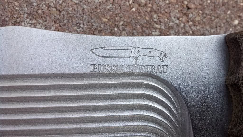

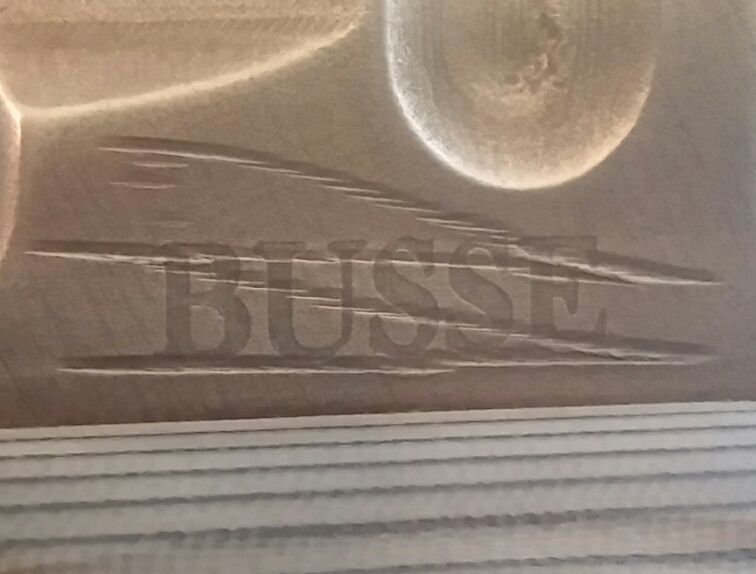

I did use circuit board etching solution from radio shack. I did this in four segments. The blade coating protects the area you don't want to etch. So etch the logo before stripping the coating. I used a q tip to apply etching solution to the logo. Let it sit for an hour then I rinsed and dried it off and repeated three more times for a total of four hours. I think I could of done it a couple more hours so it could be a little deeper. If the solution dries out apply a little more. My blade has the mysterious zig zag lines over the logo.
way cool Ausher, those lines are bada$$ and lend a real blue collar vibe to my favorite USA product...and thanks for sharing everything, members like you and resinguy and many others here make this a great place to hang out and learn! :D

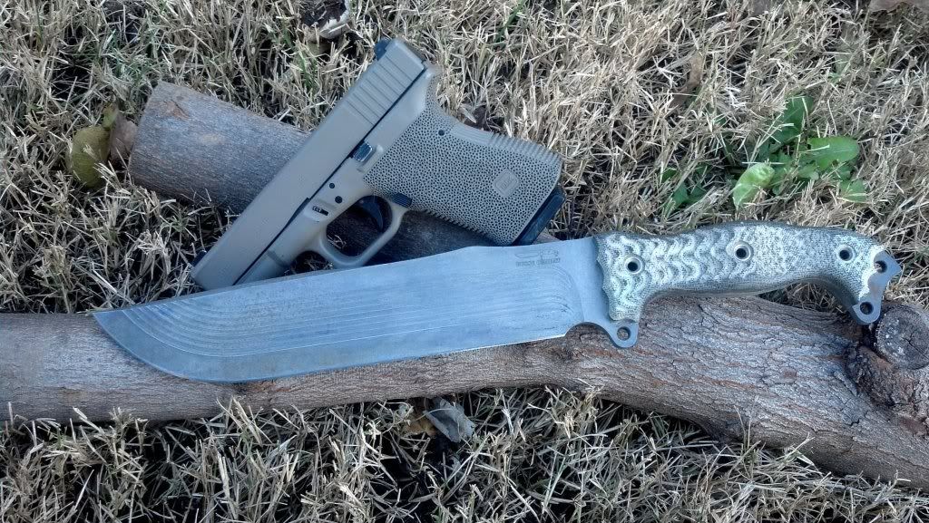

I think that I have tried a stainless wire wheel with an electric drill. But I now use a ScotchBrite wheel chucked into the drill. I clamp the drill body into a vise, set it for medium rpm and lock it on, then (while wearing cut resistant gloves) buff the blade against the wheel.
Glad I could of been some help for once:) the bare INFI looks great and doesn't need all that paint covering up the beauty.

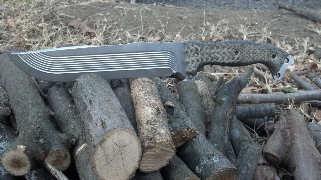

seriously, though, that is a top tier strip job, jd4320t and I am jonesing for that knife now...
and clampdaddy your TGLB looks like it could be fresh outta the Custom Shop , your skills & techniques are fantastic, thanks everyone for sharing! :)

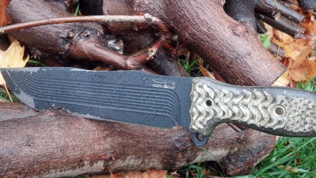

Wow, thanks guys--both blades look great! So, I noticed that neither of you covered up or removed the micarta... is that right? No effect from the stripping agent? Thanks again.
don't waste your time masking the scales Aias...the stripper will remove some of the "seasoning" or patina from your natural oils...
they will look kinda dull...but you can reapply the oil of your choice...
but I've found the G10 to be pretty bulletproof stuff & will laugh at the most virulent stripping compound...
paper Micarta..ditto as far as absorbency, I've had it slathered in stripper with no ill effects...

It does not hurt the micarta at all. After rinsing the stripper off in the sink, hehe, the micarta looked nice and clean
What did you use to get the decarb off/out of all the grooves? And while vie seen this blade on various occasions, might you tell me the name/ initials it goes by? It is a bad-a$$ beast...
I used a ScotchBrite wheel. It did a pretty good job but it didn't remove it all. It was done over 1.5 years ago and the knife has been used and abused so I need to hit it again. It doesn't have a name but it was my first and I'll never get rid of it.
