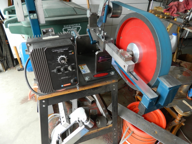

There's a handful of nit-picks I've got with my KMG, but without question the one aspect of it I despise is the pulley system. Hate it. Noisy, vibrates like hell, inefficient and just plain sucks. I can stall the same 2hp motor I was using on my Wilton, and using no where near the same degree of force it took on that old machine. As far as I can see, there's no reason I can't snag a decent piece of 1/2" or thicker plate, perhaps 8"x8", square it up, cut a c-face mounting hole in it, and bolt it to the existing subframe and get back to work.
Has anyone else done this? If I don't have to reinvent the wheel or run into snags, I'd much prefer hearing about what I'm NOT thinking of, rather than diving in and shutting myself out of business until I return it back to pulleys...

Sorry, Fred. Yes, it's direct drive. My thought is to eliminate the entire pulley assembly, mount a plate to the far right side of the grinder (about where the existing shaft bearing is, just before the drive wheel), and be done with it. Does that make more sense?

There have known of a few folks who converted to direct drive. I know of one who used a lovejoy type coupling to connect motor shaft to the drive shaft. NOT my favorite way of doing that - I'd prefer to remove all pulleys/shafts, mount motor direct to a base plate with drive wheel mounted to motor. Mount motor in such a way the drive wheel is in line with sanding belt. You could adjust the the motor so the wheels all line up making belt run true. This WOULD require a 3 ph motor with VFD so you could control speed - UNLESS you're wanting only a high speed grinder.

Yes, I have a C-face motor, 2hp 3ph with a vfd. My thought is to eliminate the pulley and bearing kit entirely and put the motor right where that stuff is, with the drive wheel in the same vicinity of the original.
I just did that upgrade to my kmg, I unbolted the rear pulley set-up and got rid of the base plate and replaced with 1/2" aluminum plate and bolted the motor down to the plate where the pulley setup used to reside.
If I had to do it again I would go with thicker plate because when you tension the belt it flex's the plate like a bow.
I will post a video of the mod tomorrow.
I also have a c face motor but just bolted it down to get started, I'm waiting for a big chunk of angle to make a bracket to bolt on to the grinder body.

Robot - you use 1/2" plate and it flexed with just belt tension? You must be putting heck of a LOTS of tension on the belt - but maybe there's more stress than I ever realized on the baseplate?
Matt - you got 3 ph and VFD? Go for it! Just like you said, use a baseplate to bolt motor to. The first 2X72 grinder I built used pulleys and worked good, but after I did a direct drive there was no comparison to smoothness and quieter running. Somewhere I have a video of it running at 4,000 SFPM with a quarter balanced on tool arm.

It seems to me that the big problem with going to direct drive is the size of the drive wheel. If you use a 1725 RPM motor with a KMG the pulleys double the RPM before the 4 Inch drive wheel . You could double the RPM by using a 8 inch drive wheel but the SFM would still be less than the standard KMG setup. OK, you can set the VFD to double your speed but that is not preferable because of the loss of torque at lower speeds OR you could use a 3450 RPM motor and still lose lower speed torque. I have a KMG and love it. I also built a direct drive Polar Bear Grinder with a 2 hp 3450 RPM motor and it works ok but I really prefer the KMG. I would suggest you check the tension on you belt and use cast iron pulleys like Beaumont Metal Works supply. If you have to go direct drive consider buying a second grinder or sell yours and get another. Good luck. Larry Lehman
