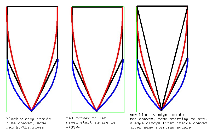

Depends. From v to convex. Keeping apex angle the same, you grind/thin the back bevel and shoulder. However, keeping the back bevel or shoulder angle the same, the apex will be more obtuse. This is why some say convex is stronger..
From convex to V, you'd definitely reduce the apex angle. Imagine running straight line from shoulder to apex.

I saved one of the many diagrams showing this (unfortunately, forgot to save who made it, sorry)...
I wish that eventually users would understand the red lines don't belong in that diagram...
Comparing the red lines and the black lines is pretty much like comparing a folder to a fixed blade, and pronouncing the folder superior in sharpness...
I had a knife professionally converted from the black lines to the red lines, a full height convex, and the 0-1 steel chipped and crumbled with astonishing ease... Even in its thinner condition, it did not really cut as spectacularly as its thinness would imply, because the initial apex aggressivity is always poorer on a convex...

Why dont the red lines belong??
Hi,
Because that is a thinner shoulder,
thinner than the blue convex
and thinner than the black V-edge
the blue and black are same height, and begin at same width (thickness),
the red convex is much much taller,
If you want to compare the red convex to a v-edge,
you'd have to draw a new one,
one with the same height, example
the green square is the metal you begin with,
the width/height,
convex will always be fatter than v-edge given same starting square
