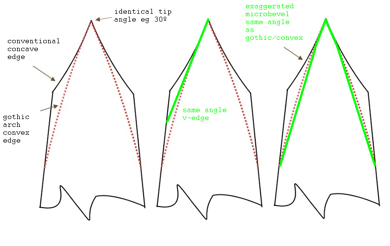

I think the red absolutely belongs, but I guess it all depends on one's definition. If you make a V edge with same shoulders as the red convex, it no longer has the same terminal edge angle.
Based on the argument that the red convex cannot be compared to the original black V bevel due to differences in shoulder height, the new black V bevel cannot be compared to the red convex for differences in final edge angle.
Of edges with the same terminal angle, the convex always has less mass behind the edge.
Without defining the criteria it is not possible to have a conversation on this topic.

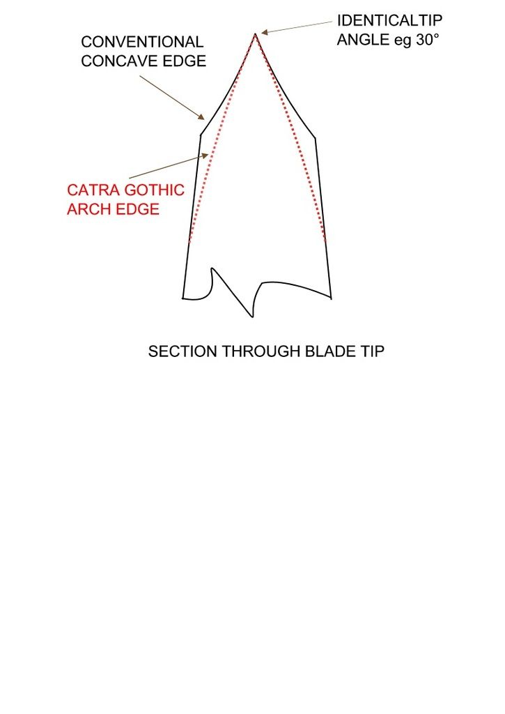

This is how CATRA defines it:
Yes the gothic arch edge does have less material behind the edge than both concave and flat ground edge bevels.
The CATRASHARP model has this type of wheel as standard and is 32° at the edge and 30° at 1mm back from the edge.
On a related note, I do convex edges on a 10" wet wheel by having a forward and back stop on the blade clamp. As it slides fore and aft on the tool rest the wheel can cut an arc of known stop and start values. If the amount of play is restricted enough one can cut a dead flat bevel instead of micro concave.

Hi,
Yeah, of course it belongs on the image ;) as an example of appples and oranges comparison :D
All it takes to match the angles to add a microbevel a truly "micro" bevel unlike the exaggerated one in this image
Catra is marketing , comparing to some of their competition, commercial single-stage pull through sharpening machines

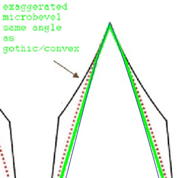

Ahhh, now that's nice and snug - thin blue line is new convex with same terminal angle as previous yet even more thin behind the edge.
Anywhere you have an area bounded by straight lines intersecting to form an angle, you can join them with an arc and reduce the surface area. It doesn't matter what scale. This holds true right up until the two intersecting lines become a straight line.
Apples/oranges or potāto/potăto...
But you do realize drawing it inside the V-Edge is not an informative comparison?
Gaston
It's a comparison based on the edge angle, it's not just "drawing it inside the V-Edge". So, it is an "informative comparison".
I wish that eventually users would understand the red lines don't belong in that diagram...
Comparing the red lines and the black lines is pretty much like comparing a folder to a fixed blade, and pronouncing the folder superior in sharpness...
I had a knife professionally converted from the black lines to the red lines, a full height convex, and the 0-1 steel chipped and crumbled with astonishing ease... Even in its thinner condition, it did not really cut as spectacularly as its thinness would imply, because the initial apex aggressivity is always poorer on a convex...
Great for chopping free-hanging manila rope though...
Gaston
Again, it's a valid comparison based on the edge angles. Your example of how the convex edge performed has so many variables... it would be difficult to form a meaningful conclusion. (Also, the red lines are not a "full height convex".)

Hi,
I copy/edit the original image posted in this thread
to point out the critical issue
of the starting point/box/rectangle/square
not being equivalent
The original red convex
already changed the critical parameter (width/thickness)
thus invalidating the comparison between convex/vedge.
Comparing the red convex , a thinner edge,
to a thicker edge (either black convex, or v-edge ),
is unfair comparison for deciding if convex
has performance advantage over v-edge,
thinner edge is always thinner than thicker edge.
The important difference is that it is thinner,
not that it is convex.
Both thinner convex and thicker convex are convex,
the thinner one will have performance advantage over thicker one
Yeah, you can always draw a thinner convex inside a v-edge,
but then its a thinner convex, not equivalent starting point,
you can just as easily draw a thinner v-edge inside that ,
keep changing starting point to infinity and beyond...

It's not 'invalidating the comparison'... that is the comparison. Given an edge sharpened at the same (approx.) angle... this is what the comparison is: (convex is thinner, larger bevel, etc.).
If you want to say 'Given an edge sharpened at the same bevel height', which is what your box shows, then you have a new comparison: (flat grind is thinner, etc.)
It doesn't invalidate the comparison just because one or the other is 'thinner'... otherwise both would be invalid. It's simply a comparison based on a given parameter. In the case of the red line, it's the angle sharpened at. You could make a third comparison... What would the differences be, if both types were as close as possible to the same thickness?... and you'd have a new set of differences.
Isn't this all a bit pointless to try to compare? Convex and V are two different shapes with two different performance characteristics.
The main performance difference between Convex and V is that Convex has a rounded transition to the next part of the blade grind. In other words, the "corner" between edge bevel and blade has been smoothed out. So a convex will (mostly) cut more easily due to less drag in that area.
But again, they are DIFFERENT. You can't compare them unless you really nail down exactly what you are trying to compare. Do you want the same bevel height? Or the same width at the top of the bevel? These are two different things and you can't have both with these two different shapes. Do you want to compare mass in the bevel area?
What about actual cutting comparisons? You can see how this quickly gets way too complicated to make any kind of simple comparisons.
