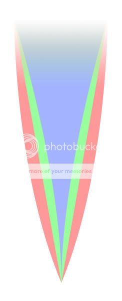

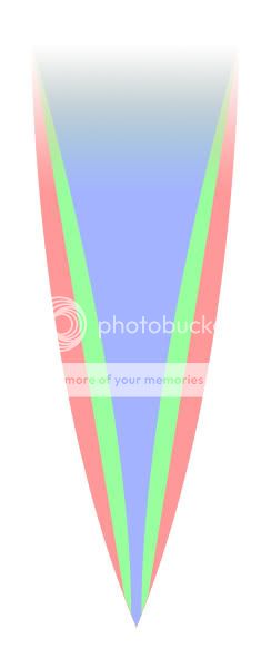

Just for the record, given equal inclusive edge angles at the very edge, a convex edge has LESS metal behind it than either a flat ground or a hollow ground blade. A convex edge has more metal behind it than a flat ground or hollow ground edge ONLY if the edge angle is more "obtuse."
If this does not make sense, draw three "V"s, one straight, one convex, and one concave, all with the same "apex" angle, and see which one makes the fattest V.
Convex edges are considered stronger only because they are more "obtuse."
With your assumption you would end up with different thickness of the blade for each grind...
If you stick with a piece of metal with equal dimensions and just apply different grind:
That also works off the presumption that the flat and hollow grinds are zero bevel, generally that is not the case.
Not necessarily. Your assumption is in a full height (zero edge) grind. In this case you are comparing apples and oranges. The hollow will be a much better cutter because it has a much more acute angle. The same goes with the V-edge. Of the three shown in the above picture, the convex ground one will be the worst cutter of the bunch. It has the least acute edge angle (tangent to the curve of the blade grind at the apex of the edge).
Unfortunately, I have neither the skill nor the software to produce a picture of it, but you can start with the same stock and also give each grind the same edge angle (see above for definition), the difference would be in the height of the grind. The hollow would have the shallowest grind, the V-edge the next shallowest, and the convex would have the tallest grind- given the same stock thickness and the same edge angle. In this comparison, contrary to popular "wisdom" the hollow ground blade would have the most steel behind the blade, and the convex would be the "weakest."
Of course, the hollow grind would be best for shallow cuts, as it rapidly gets thick, and the convex the best for deep BECAUSE it has LESS metal behind the edge. Convex edges make good choppers because they have less metal behind the edge (less drag= less wedging= deeper penetration= better chopper) than an equally ground flat grind or hollow grind. However, they are ususally compared as in the picture above (full height- zero edge- grind, equal stock thickness). In this comparison, the convex will be the most "beefy" at the edge, but will also be the poorest cutter (least acute edge angle).
Think about how you make a flat gorund edge into a convex ground edge. (assuming not ground "zero edge") Most people advocate grinding off the "shoulder." Removing metal from the shoulder does not magically put more metal behind the edge.

Assuming that both bevels terminate at the same included angle (and why bother comparing them if they don't?), then that is factually inaccurate. I just whipped this up in a CAD program, to illustrate the point:
attachment.php
They're both 40 degree edges on a 1/8 thick piece of material. There is visibly more material inside the V-bevel shape than there is inside the convex bevel.
Given equal stock and an equal edge angle, the convex edge has LESS metal behind it.
