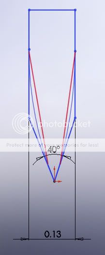

As for the Lucky Bob's picture and claim that convex is thinner than other grinds:
if you make flat as high as convex, then flat is thinner.
Lucky Bob's diagram is based on the premise that the tangent to the curve at the apex of the edge (the "edge angle") is equivalent for each grind, whether it be convex, flat, or concave. Given that constraint, the convex grind will ALWAYS BE THINNER. You can make a convex grind thicker by increasing the edge angle, but you sacrifice cutting performance. You cannot have both the thinnest edge and the most metal behind it. If you cannot wrap your head around this then you need to go back to geometry class.
Look at Huugh's color picture on the last page. The fattest grind is the convex grind. Also, the grind with the most "otuse edge" is the convex grind. It may be the most robust, but it is also the poorest cutter.
Now look at the picture by Lucky Bob. Both edges have the same included angle, so there is no bias based on edge angle. They are also from the same stock. The convex ground blade is thinner, and must be thinner if it is going to be convex.
Huugh has obfuscated the issue by drawing a flat grind within the convex grind to show that it is thinner. However, by doing this he has reduced the inclusive edge angle of the flat ground blade and made it a much better cutter in the process.
Regardless of how it is ground- flat, convex, or hollow- the only way to make a blade more robust at the edge is to sacrifice cutting performance (increase the inclusive edge angle). And, given the same inclusive edge angle, a flat ground edge is more robust than a convex ground edge.
Note that the above discussion is under the asumption of no microbevel at the very edge.
Different types of grind on the same blade with the same height produce different edge angle. That's obvious and is in fact the reason why there are different types of grinds - to change cutting performance.
Hollow needs least height of the grind to match the specific edge angle, while flat needs more height and convex most.
This picture respect Lucky Bob's (improper) premise of equal edge angle. Not very illustrative, as it only seems that convex is thin, while what you really see is that convex needs much more space to match the angle.
For fair comparison, you have to give them equal conditions. That means, stick to the same stock, the same grind height and only change the type of the grind. I already posted those illustrations.
There are also a number of possible convex curves possible that yield the same edge angle within the same width of stock. Some would be very close to the flat grind. Mike Stewart mentions than the blade stock forms an approximately 13 degree angle to the slack belt in their convex technique. However, that is not the resulting angle at the edge as the belt curves around the stock. What that final edge angle is I don't know nor has Mike mentioned a precise finished angle, probably because if varies a bit from knife to knife that comes off the line.

Given equal stock and an equal edge angle, the convex edge has LESS metal behind it.
