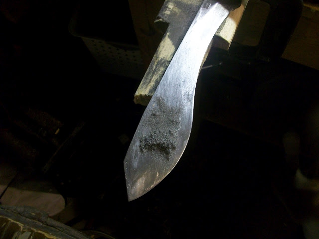

So after using my Machax for a while, I have decided to convex it. It bites real well, up until it reaches the primary bevel. So I decided to knock the shoulders off of it and thin it out a little.
First step, dull the edge. (I had to run the edge down a file after this.)

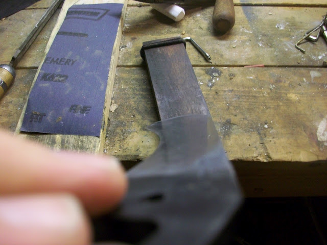

Then the handles gotta come off. Sorry about the crappy pic.

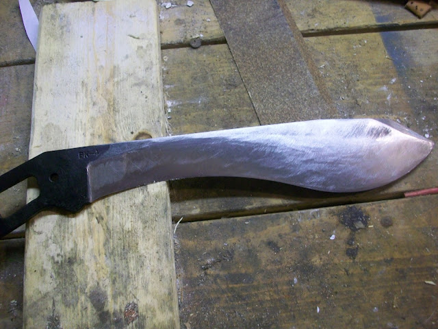

I decided that it would be a good idea to sand the coating off, so it wouldn't clog up my file.
15 minutes and a couple slices of 60 grit later.
Other side.

Coating, I SMITE you!

Next I chalked up a file.
And started filing.

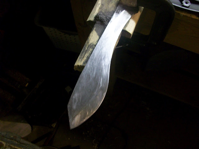

Did some more filing.
This is just a little bit of the steel that got filed away.
Don't file into the edge. Trust me.
It's to the point where I can no longer feel the shoulders of the bevel, so I took it out and it went through 1 inch branches with ease, without an edge.
Pretty anxious to see how it chops once I finish and get an edge back on it.

Did some more filing. Think I may be done.
I can no longer feel the shoulders, and it is a smooth transition all the way down to the (unsharpened) edge, except at the beginning of the bevel, as evidenced in the pictures.

Mind taking a photo from the tip to the handles, so we can see what your convexing looks like? You, my friend, need a belt grinder :) That's a lot of elbow grease. I'll be interested to see what your end result is after hand polish.
I tried getting a couple. That is one tough angle to catch, especially in my poorly lit dungeon.
