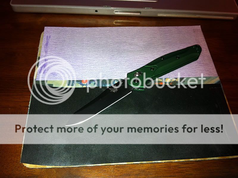

Let me preface this post by saying that I've successfully put a convex edge on many of my kitchen knives. These knives are scary sharp and a joy to use. I just purchased a Benchmade 940 with the S30V steel blade and was confident in my abilities to achieve a razor sharp convex edge on this knife. However, after two days and many attempts, I have been unsuccessful.
Originally, I started with 1000 grit on the factory edge (which was shave sharp) and was able to improve on it a bit. However, it seemed the more that I polished, the duller the blade got. Today I went out and bought 320, 600, and more 1000 grit sandpaper. My thought was that the edge just needed to be reprofiled a bit, then surely it will take a mean edge, right? Well... so far, this has not been the case, and i'm beginning to get a little frustrated.
I'm using the sandpaper on a rubber/foam mouse pad and doing everything (as it seems to me) that all the instructions and videos have outlined to get a "hair popping" edge; however, unsuccessfully achieving that goal with this knife. I'm trying to figure out what i'm doing wrong or if what i'm using is inadequate for the task (e.g., mouse pad too soft, bevel too steep, etc.). I thought id figure it out, but for the sake of not grinding my knife blade down to a nub, have to ask for advice. So, any ideas?
My "rig" this is 320 on one side and 600 on the other.

I'd use a firmer backing for that blade. S30V is very abrasion-resistant, compared to the kitchen knives you've done previously. The soft backing pretty much dictates going very light on pressure, to avoid rounding off the edge. Problem is, that light pressure on soft backing is going to make for some very slow going with that steel. If you're like me, there's a natural temptation to 'press harder' in that situation, to speed the process along. That'll just round/dull the edge on the soft backing.
If it were me, I'd be using the same technique, but on much firmer backing, like very stiff leather, and not too thick. Another easy way to regulate the firmness of the backing is to use a magazine/catalog/newspaper as the backing for the sandpaper, over a hard surface like glass or hardwood. Adjust how many magazine pages are under the sandpaper, to regulate firmness and control the amount of convex in the edge. S30V is some very tough stuff. A slightly shallower/thinner convex would suit that blade just fine, I think. If you need to, re-establish the convex bevel from the beginning, with the coarse grit on firmer backing. Make sure you apex the edge (look for the burr), then use the subsequent grits to refine it, at progressively lighter pressure. The finishing grit should be done very, very lightly, to protect the sharpness and integrity of the new edge.

A little update on my situation.. I started to pay attention to the mouse pad that i'm using and noticed that the surface of the pad has a cloth-like overlay on top of the actual pad material. I started to think that, perhaps, this cloth is too soft and allowing too much "give" in the wake of the blade on the sandpaper--creating too much amplitude in the wave trailing the blade and removing the edge. I then flipped the pad over (raw material facing up-cloth side down) and gave the knife a few strokes on the 600grit. This seem to work well as the knife took a pretty good edge in just a few minutes. I'll work more on it tomorrow and report back. I may end up having to search for a firmer mouse pad to use.

Thank you for the advice--I believe you're right. I'm looking into a firmer pad as we speak. What do you guys think about a piece of glass/hardwood with a few layers of wide blue painters tape to regulate the amount of padding under the blade? Seems like this might work very well for this application.

It's soft enough. He only needs to choose the number of layers to accommodate for the pressure he's using. I often use a few sheets of paper to accomplish the same thing (as I described above). In the finishing stages especially, where light pressure is important, you don't need much thickness to make the backing just forgiving enough, without being too soft, and rounding off the cutting edge.

I would like to make a case for thinning out the edge of these "super steels". S30V is plenty tough when taken down thin for a super slicer and it's strong enough to resist rolling an edge or chipping out. To me, that is the advantage of these steels VS milder or more brittle steels. I think you may be putting way too much effort for no, or even negative returns.;) Convexing shines in steels that need added support of of a fat support structure behind the working edge.

My favorite method for convexing involves initially putting a more acute V-bevel on the blade, usually with a guided setup (I use my DMT Aligner/Magna-Guide). Then I convex the shoulders using sandpaper and firm, thin leather or magazine/catalog pages over glass as the backing, like I described earlier. Being that the newly-created edge is already crisp & pure, I focus on protecting that new edge while smoothing out the shoulders (keep the angle conservatively shallow). The best of both worlds, when done carefully to completion (smooth convexed shoulders + pure, cleanly-apexed edge).
Still trying to get a nice razor's edge on this knife. It's as if i've hit a wall and can't get it any sharper--no matter what I do. Maybe I should just stick with a regular V edge. This knife has so far defeated me. Maybe a regular V edge will work better--the factory edge seemed sharper than what I have now..after hours of sharpening. :jerkit:
Success!! I spent about 15mins on the 1000grit using very light strokes and it's popin' hairs like nothing now. However, in my excitement, I shaved a little too much hair off and am now the proud owner of a few oddly placed bald spots.

Glad to hear you got it working! Those little 940s do awesomely well with a thin convex on them.
