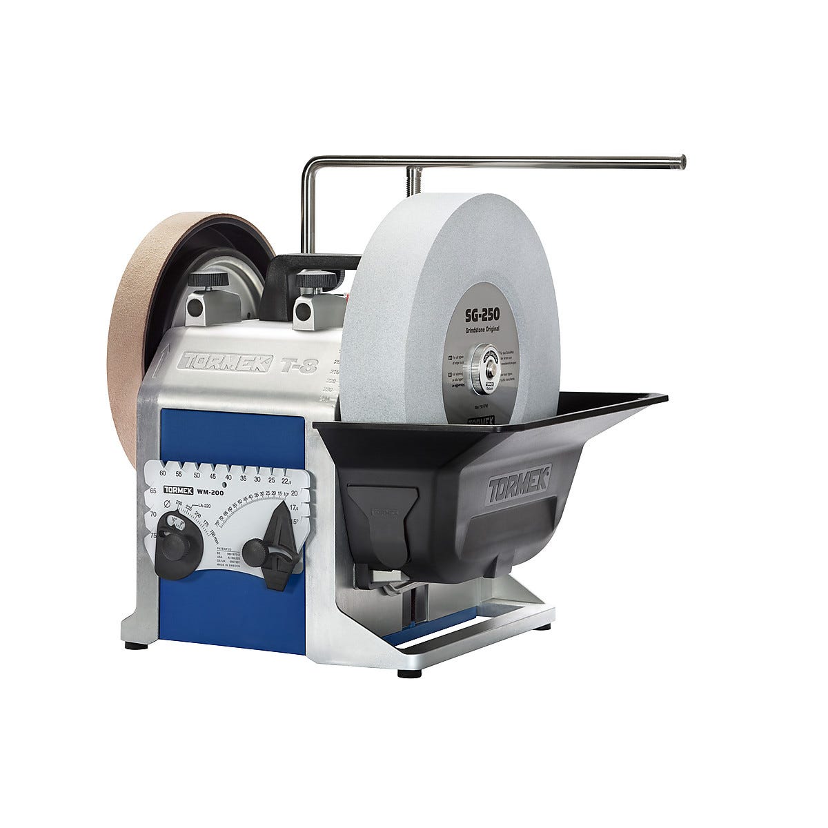

If you need to reprofile the edge, you might need some bigger guns than a Sharpmaker:
