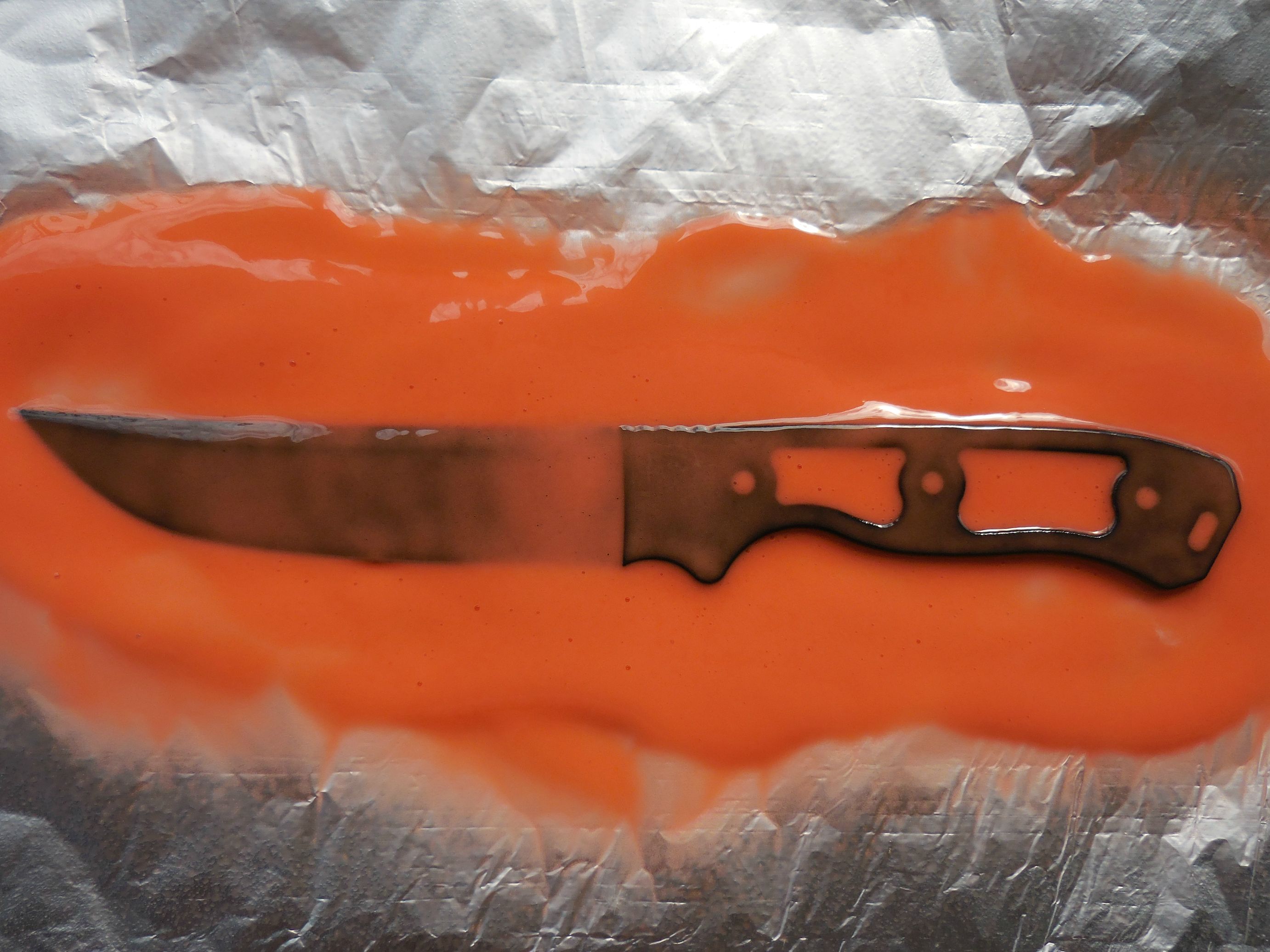

I'm seeing if I can get a "sawtooth" pattern on it by using some duct tape cut up into a spikey pattern and then putting mustard in the uncovered area.
Nah, never mind...it looks better black...put it back...
No thanks, it looks good the way it is... :D
The sawtooth idea failed, so now it just has an average patina on it. I'll probably get bored of this patina and do a new one soon though. Maybe pics tonight if I get time to post them after play practice.
Patinas are fun, like opening a present to see what's inside. Sometimes you get men, sometimes you get ooh yeahhh. If all else, just keep layering, no need to try to scrub off the old. I think the layers give a more authentic look.
Did you use French's Mustard? That stuff works pretty well. You have to leave it on long enough for it to start to stink... Then you know it's working.

I like spicy brown mustard myself...works great for patinas too :D
Last knife I did I used cider vinegar and it turned out weak, switched to white and it seemed a lot stronger.
Then hit it 2x with the spicy mustard. Happy happy...
