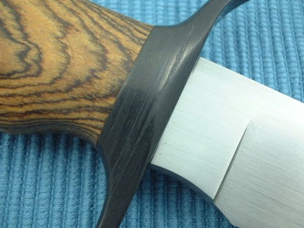

For those that don't know what russeting is:
A russet finish involves rusting the item to a nice brown finish in a controlled environment and then sealing it to stop the deterioration of the metal. It is essentially as durable (if not more so) than powder coating and is less expensive to do.
It might make for a very nice looking finish.
01 steel browned, easier said than done. At least to get a nice consistence finish as below.
