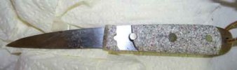

One of the knives I sent Mom for torture testing.
Of course, she dropped it off the roof when putting up Christmas lights. :D
That was the only Corian Handle I've made - I'll replace it with something else. Flubber???
