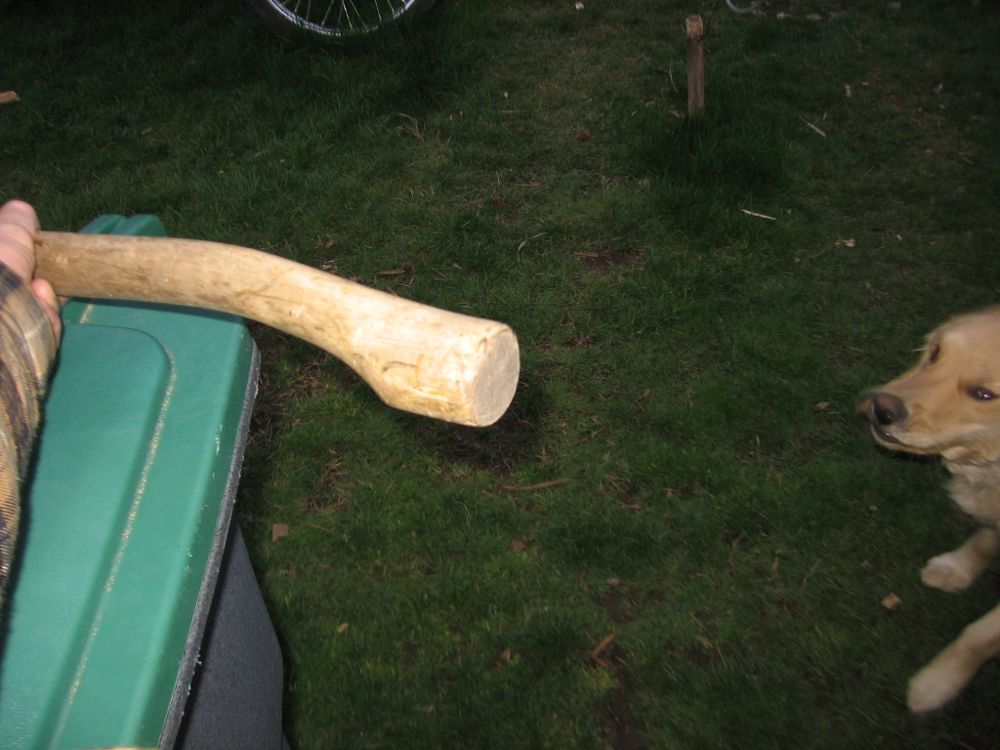

Then there's this, the stump end. Just leave some material extending beyond the fawns foot. It's a comfortable grip.
