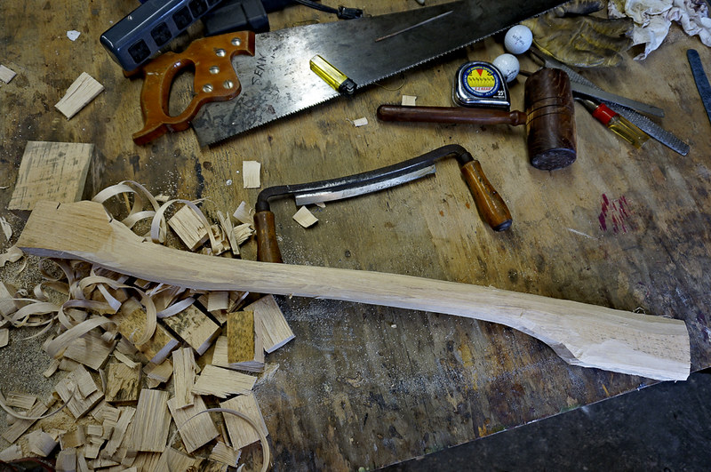

I think you guys get the idea here. Made a couple mistakes however. First while chiseling off the chunks I was just day dreaming apparently and tried to go the wrong way which resulted in a pretty insignificant, but very annoying crack. Second, it turns out these boards are thicker on one end. I just assumed they were equal thickness throughout so I had the fat end toward the shoulder, and the narrow end toward the swell. Sigh. I guess this handle is mine. I did manage to rough out a second one this evening. Both are a little further along than the pics.
axehandle_progress1 by city_ofthe_south, on Flickr
Stop cuts.
axehandle_progress2 by city_ofthe_south, on Flickr
Chisel work.
axehandle_progress3 by city_ofthe_south, on Flickr
Draw knife work.
axehandle_progress4 by city_ofthe_south, on Flickr
First run on the belt sander.
