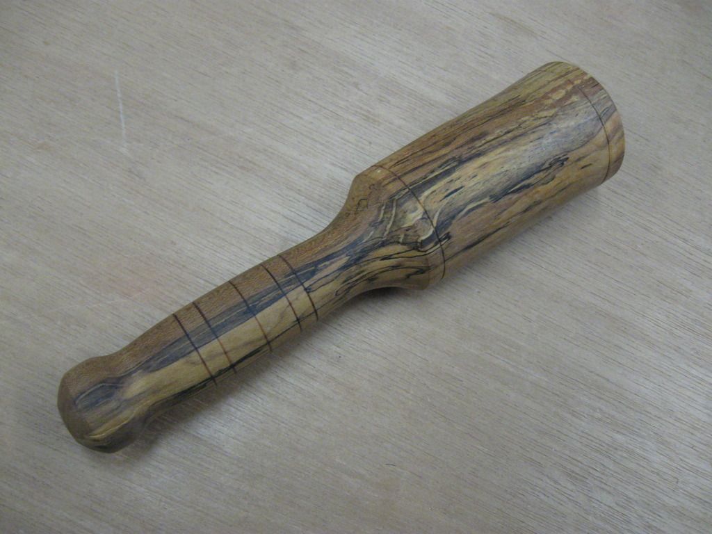

I have always avoided spalted handles but decided to go for it. I understand it could be weaker, but any thoughts on just how much weaker?
. . . but decided to go for it. . .
If the wood is solid why not? That's a beautiful looking handle. Is it spalted on both sides, looks like it is only spalted in the bottom part of the handle.
. . .I understand it could be weaker, but any thoughts on just how much weaker?
I don't know and could never find an answer. I suppose it depends on the particular piece of wood. How much spalting, other decay in the piece, etc. Made a carvers mallet out of spalted Dogwood 6-7 years ago. It's rock hard.
That thing is really good looking - the colors are remarkably similar. The spalting does go through the handle, but you're right, not all the way to the top - though the wood does have that grey tone throughout. It's not a big hammer, and he's got so many at this point I thought it would be a nice chance to learn something. It's for the science!
